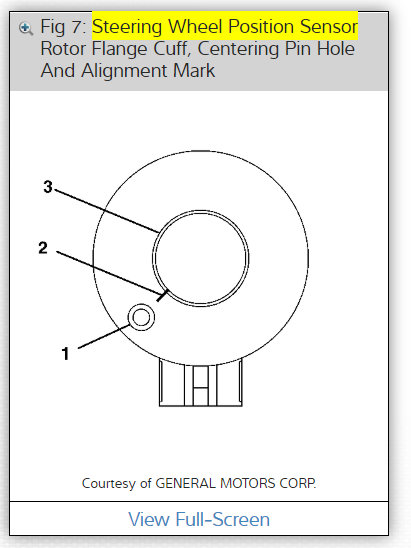

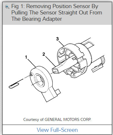

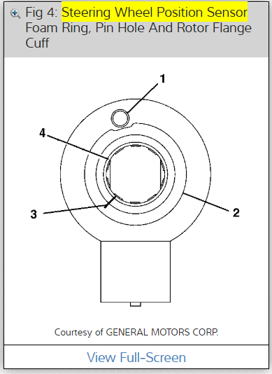

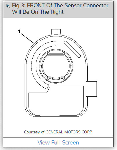

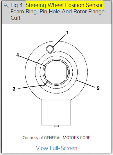

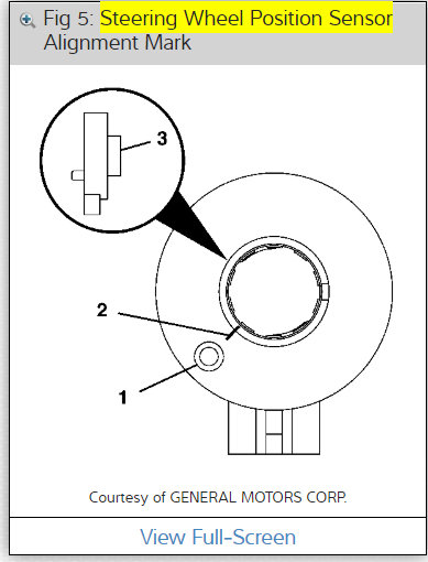

This is a common problem the steering wheel angle sensor is going out and needs to be replaced. Here are diagrams to show you what I am talking about. You will need to remove the steering column or intermediate shaft to replace it.
