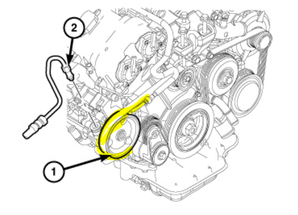

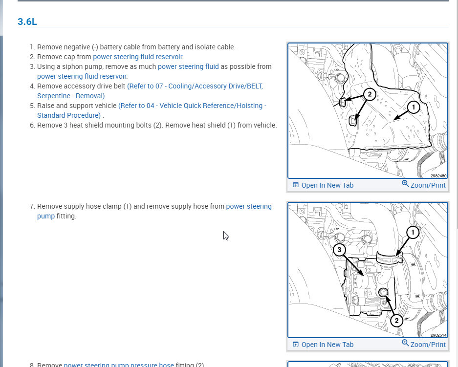

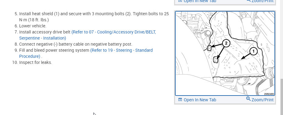

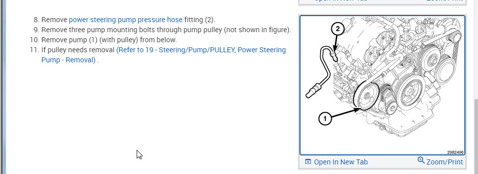

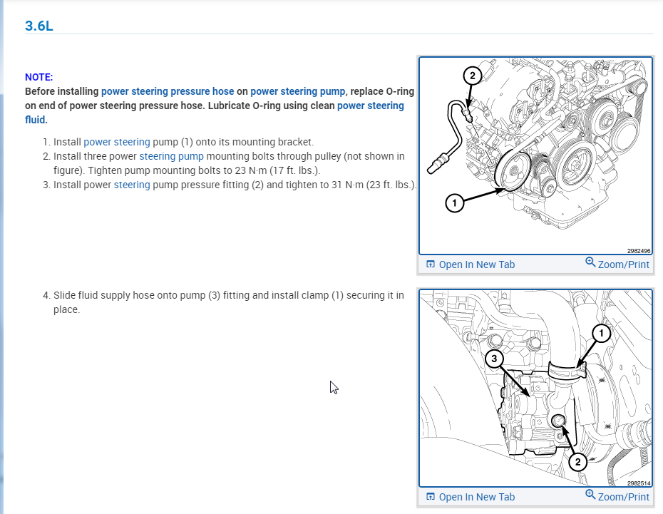

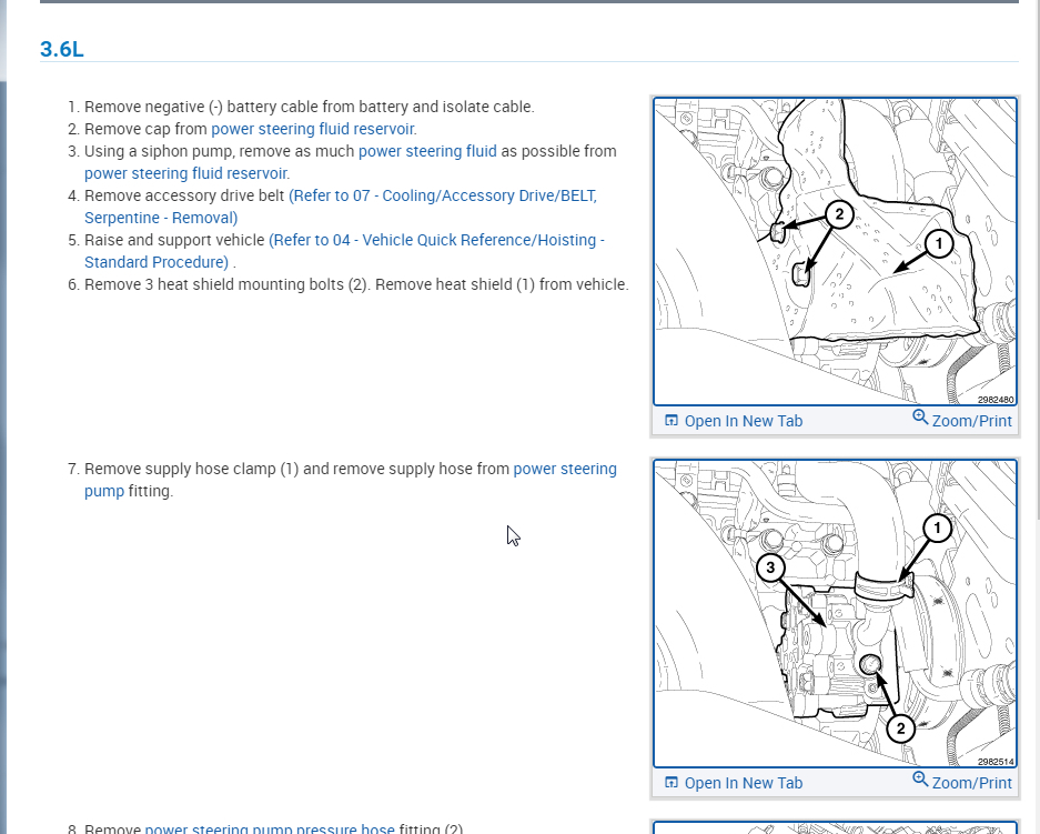

More then likely the power steering pump is failing. The way to confirm this is to check pressure when this acts up again. However, there is no guarantee that this will happen. Based on what happened I would just replace the power steering pump if you are concerned about it happening on a trip. Clearly there is no guarantee that this is the issue but it is the most likely cause.
I attached the process for this. Let me know if you have questions. Thanks

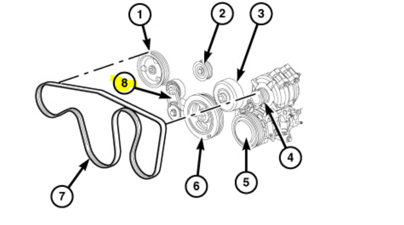

Did you notice if there was any noise associated with the failure? For example, a squealing or chirping sound? I ask because it could be the accessory drive belt (serpentine belt) may be losing tension and not turning the pump fast enough when it's under a load.
I attached a pic below and highlighted the belt. If you open the hood, stand on the passenger side front fender and you should be facing the belt. Check to make sire it is tight.

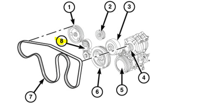

The idea that you hear a noise, the belt was replaced, the fluid is full and clean, lead me to think the belt may not be tight enough. There is an automatic tensioner that can fail. Check the belt and see if it appears to be loose. I attached a pic showing the tensioner.
Let me know what you find.
