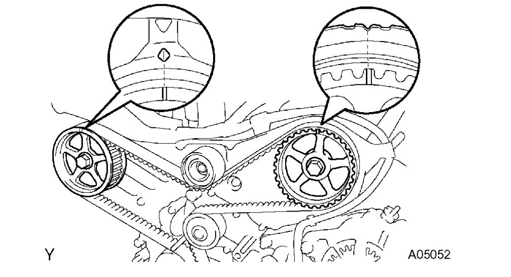

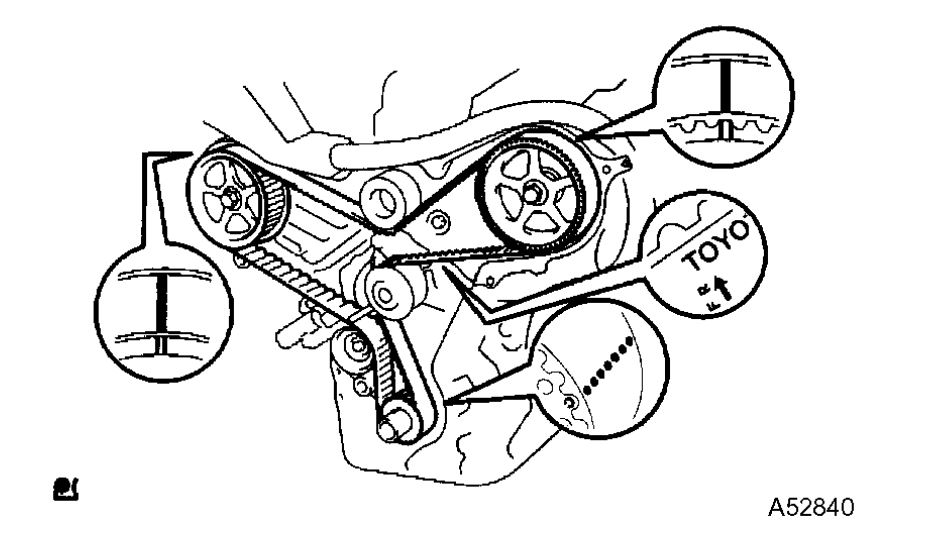

The code is for the timing. You have the belt one tooth off on one of the cams.
You will need to remove the top cover again and recheck the timing marks.
