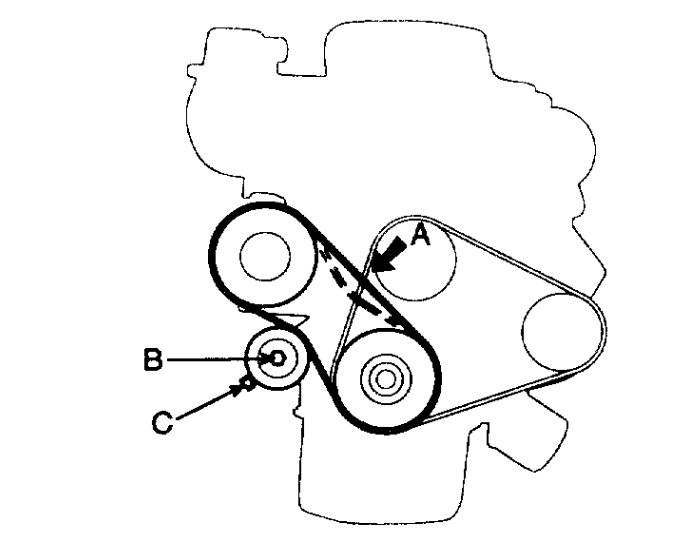

Power steering belt squeals when first turn car on initially for a minute. want to adjust the tension because the belt seems fine. how do I do that?

if the belt is in good condition adjust as follow:
Adjustment
1. Loosen the tension mounting bolt (B).
2. Turn the adjusting bolt (C) to obtain the proper belt tension, and then re-tighten the mounting bolt (B).
3. Recheck the deflection of the A/C compressor belt.
this link can help us
https://www.2carpros.com/diagrams/kia/rio/2005
Check out the diagrams (Below). Please let us know what you find.

To get to it? Wheel off and inner cover?

Yes, to have complete access you must remove the wheel and the inner cover.
