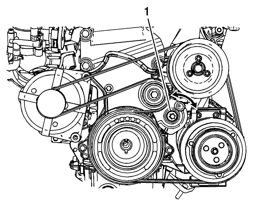

Factory information suggests to remove loosen and remove the main serpentine belt, remove the right hand headlight and air filter housing to gain access.
Image 2 shows how to loosen the serpentine belt tensioner by rotating the tensioner star nut, To access the belt you will have to raise the vehicle.

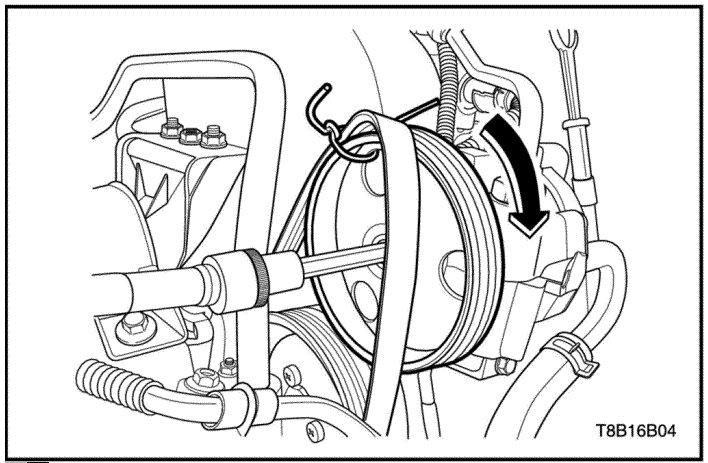

Route the power steering pump drive belt.
Align the drive belt on the water pump pulley first.
Position one of the three power steering pulley holes on top point.
Through the pulley hole tie the drive belt to the pump pulley using the rope or cable tie, see image 1 below
To rotate the pulley put the 3/8inch hex bit socket in the power steering pump pulley shaft hole.
Rotate the power steering pump pulley clockwise until the belt is fully installed on the pulley.
Remove the rope or cable tie.
Inspect for correct belt installation. If the belt is not installed correctly try to install after removing the belt.
