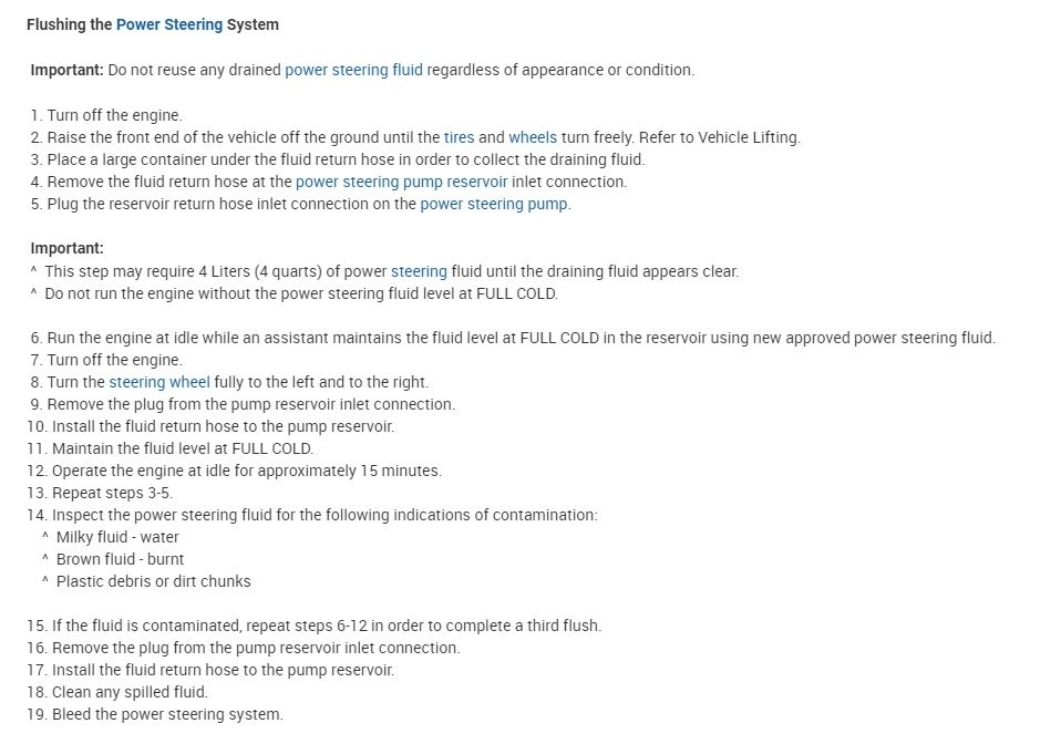

Any ideas? PS fluid flush and add conditioner? Seen this before? Thank you!
