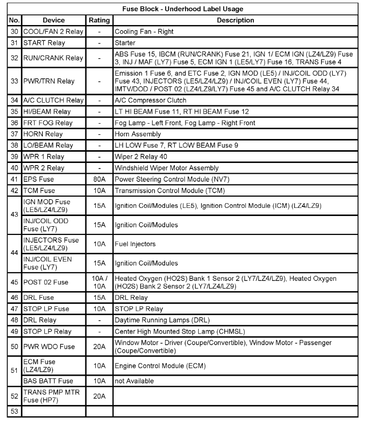

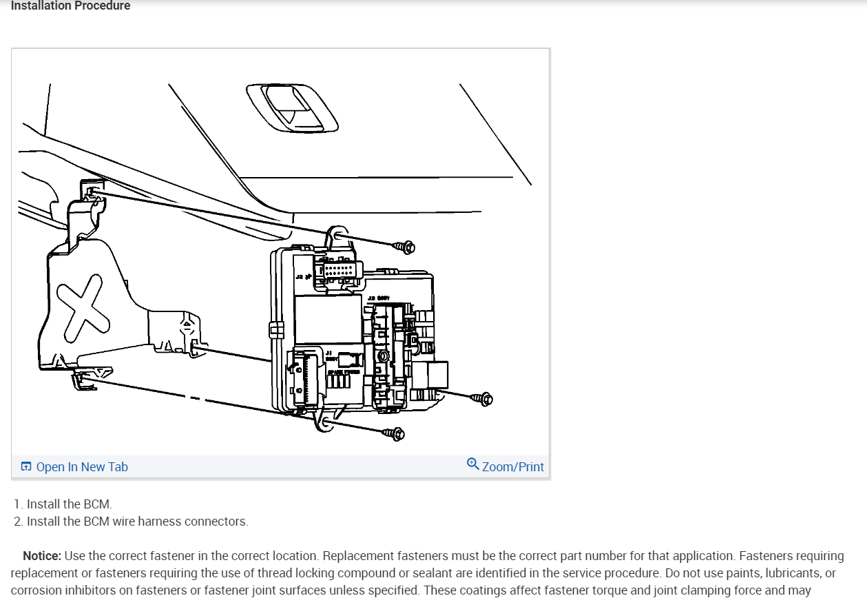

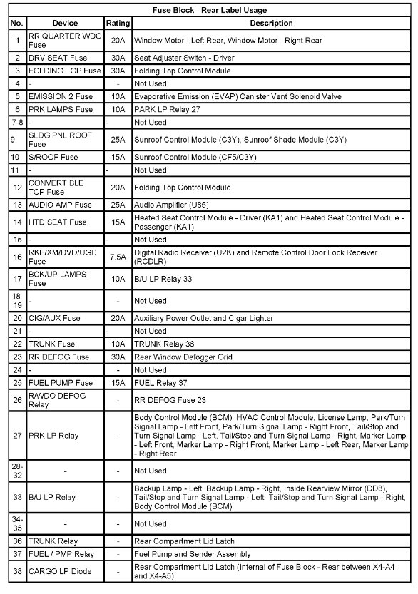

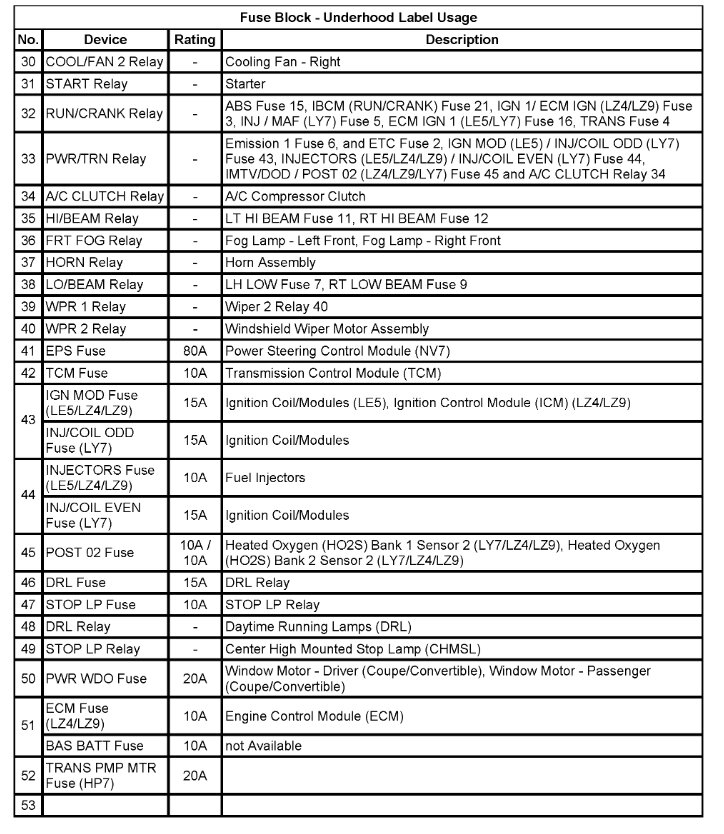

It sounds like you have found the problem in the wiring inside the door pillar. I would continue to take the car a part and inspect the wiring harness it must be damaged. I would also check all fuses with a test light.
This guide will help:

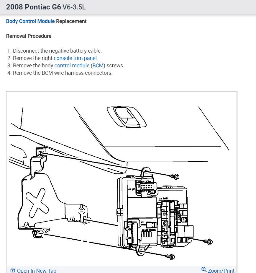

If the wiring and fuses are okay, it sounds like the BCM has gone out or has corrosion on the connector so I would check that. To see if the BCM has gone out we should do a CAN scan, you can get a CAN scanner (Controller Area Network) from Amazon.
Here is a video to show you how:
https://youtu.be/u-4syLc-ifQ
and
https://www.2carpros.com/articles/can-scan-controller-area-network-easy
Here is one for about $99.00 if you need it:
https://amzn.to/3ZixY4v

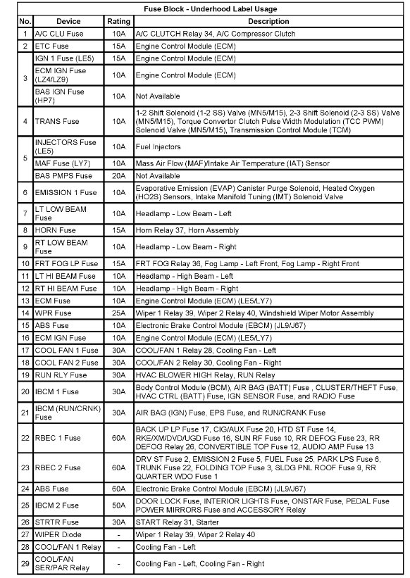

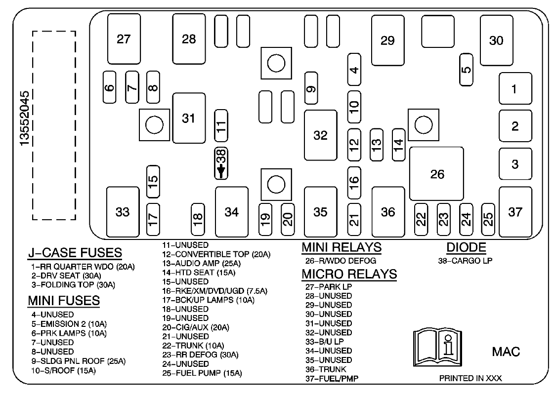

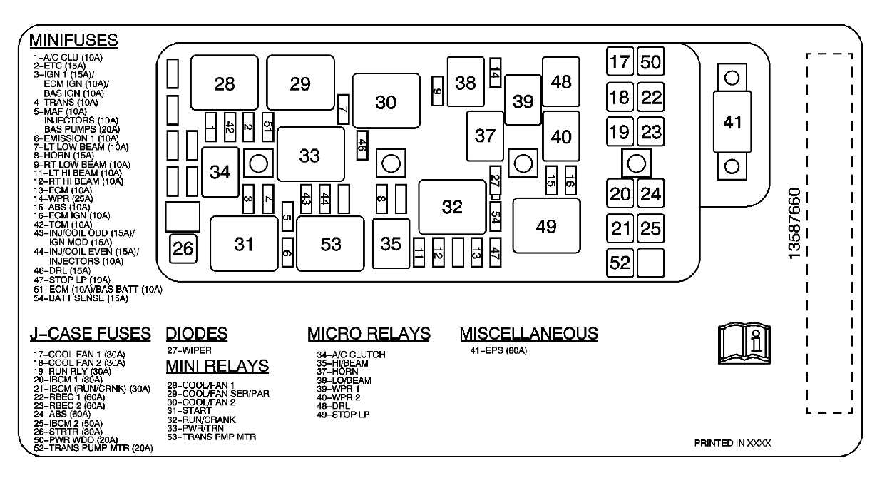

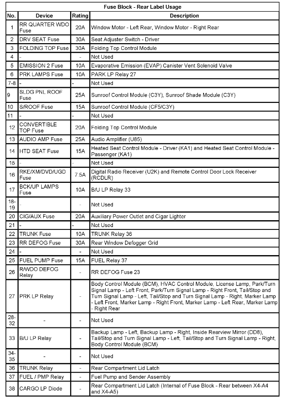

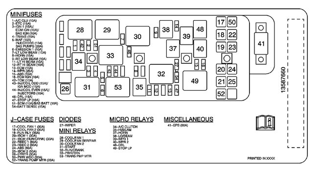

Here are the fuse locations and how to change out the BCM in case you need it, you can get a preprogrammed unit by searching Google or Ebay. Check out the images (below). Please let us know what happens.
