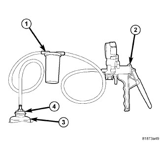

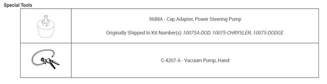

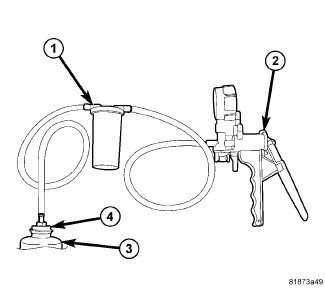

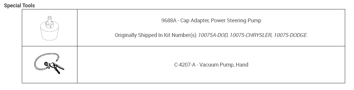

If you are hearing noise, either the pump is bad or there is air in the system. I'm not sure if you bled the new pump. Here are the directions. It requires specialized tooling to do. The attached pics correlate with the directions.

Special Tools
Pic 1
9688A - Cap Adapter, Power Steering Pump
Originally Shipped In Kit Number(s) 10075A-DOD, 10075-CHRYSLER, 10075-DODGE.
C-4207-A - Vacuum Pump, Hand

Tightly insert Power Steering Cap Adapter (4), Special Tool 9688A , into the mouth of the reservoir (3).
CAUTION:
Failure to use a vacuum pump reservoir (1) may allow power steering fluid to be sucked into the hand vacuum pump.
Attach Hand Vacuum Pump (2), Special Tool C-4207-A or equivalent, with reservoir (1) attached, to the Power Steering Cap Adapter (4).
