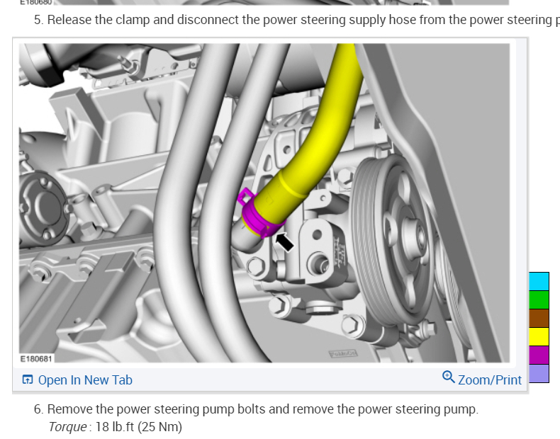

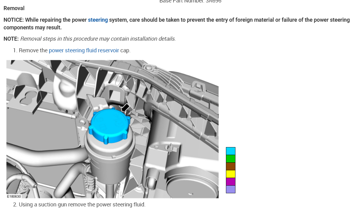

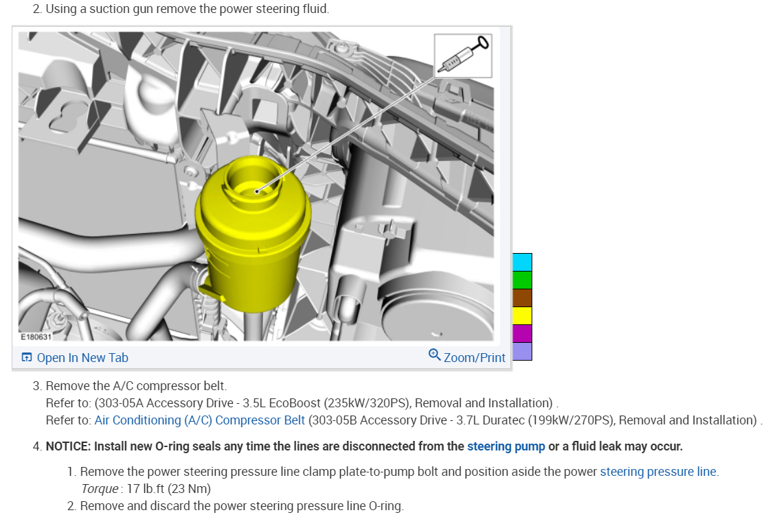

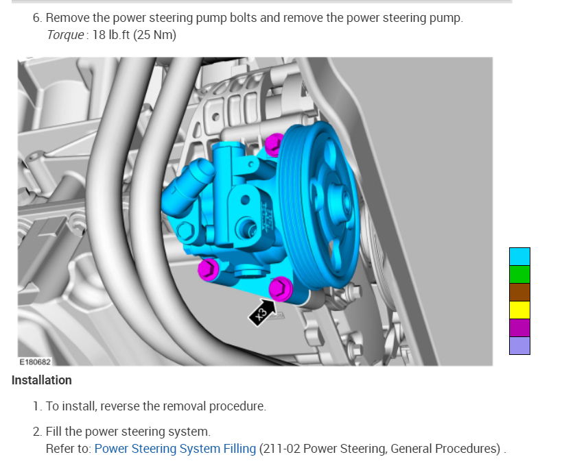

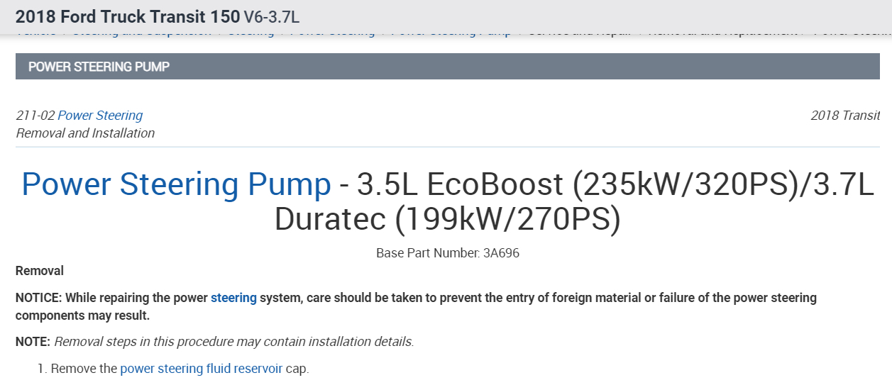

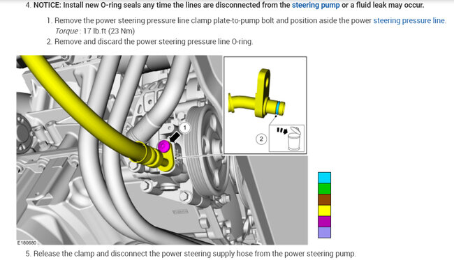

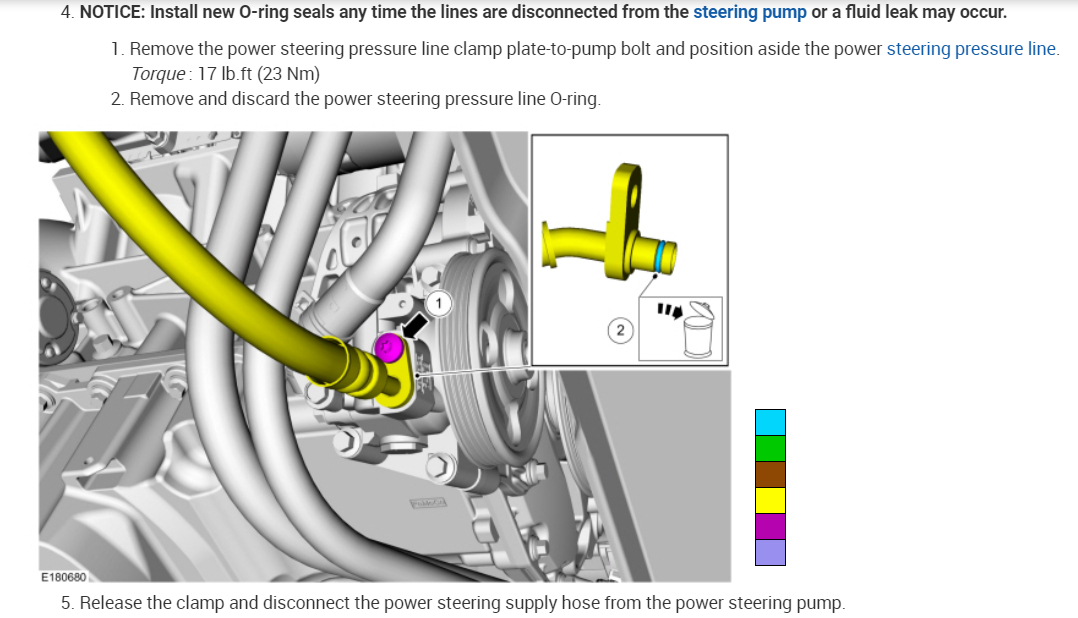

If the power steering so not working in either direction it means the pump has gone out. Here is how to replace it, also here is a guide that may help as well.
https://www.2carpros.com/articles/power-steering-problems
