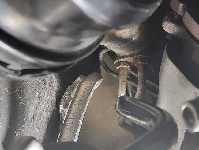

I'm trying to change the power steering return line Edelman PN 92890. I have been trying to remove this from the rack and pinion for two days now. No matter what wrench i use i can't get on the flare nut to loosen it. I believe it's a 19mm flare nut currently. The new one is a 17 but a 17 and 18 don't go at all. I don't want to just start taking things apart under the car if it's not even going to help me. Any advice would be awesome! The faster the better, also i am currently in the garage working on it now.

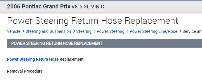

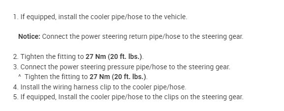

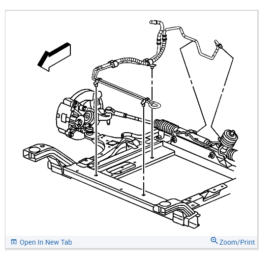

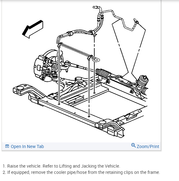

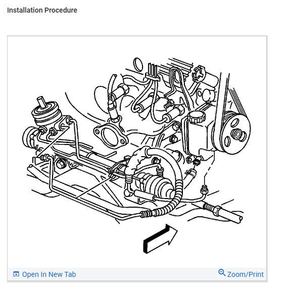

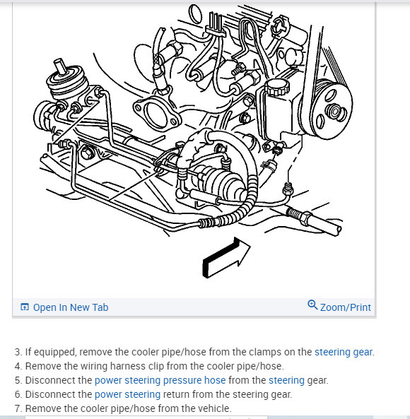

The only thing I can tell you is this. Anytime I've worked on these, the high-pressure line needed disconnected first and moved out of the way. Once it is moved, you can access the return line.

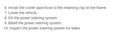

If you look below, those are the directions from my manual. Take a look through them and let me know if they help.
Take care and let me know if you have questions.
See pics below.

Thanks for the info! I have been trying to get the pressure line off. i thought there is no way to get the other one without removing that first. I have the cradle dropped down and the rack unbolted so i can move it a little to get a wrench on it but i still can't get a wrench on it. I was working on this for 9 hours today and still nothing. I'll work on it again tomorrow and let you know. Thanks again!

There is a power steering cooler. I was finally able to remove the nut, then trying to get the line out was an absolute nightmare! I did get it out, but the cooler was very tough now i have to figure out how to get the new one in. It seems like dropping the front of the sub frame would be the best but i don't know exactly what needs to happen for that to drop.
