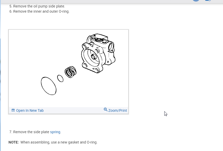

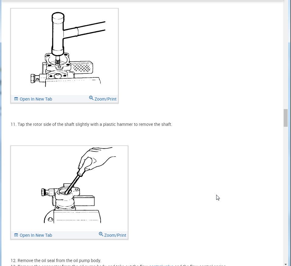

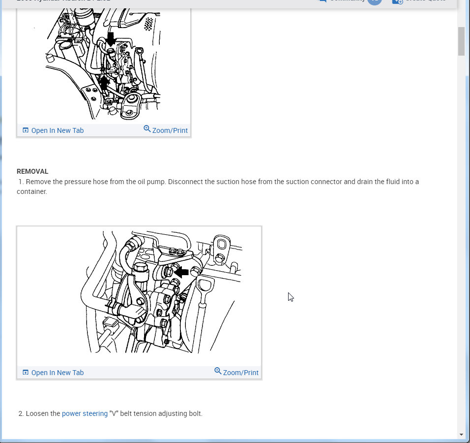

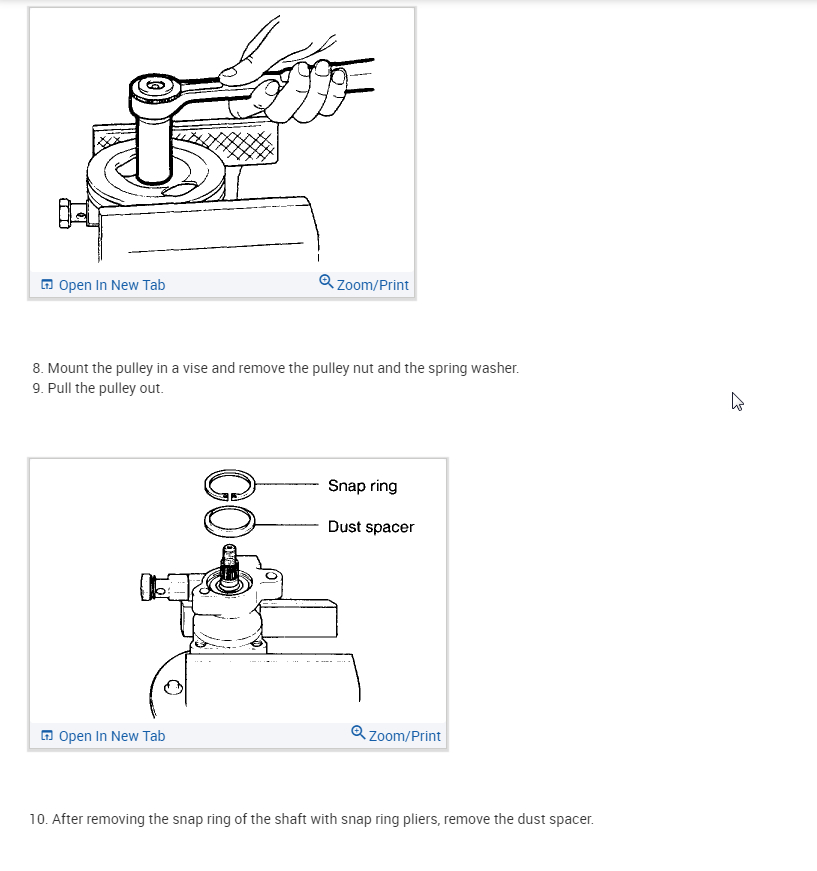

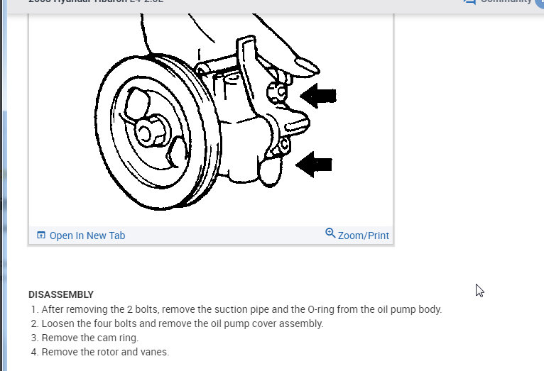

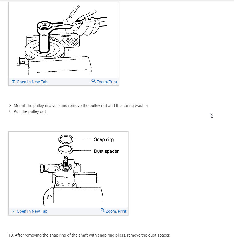

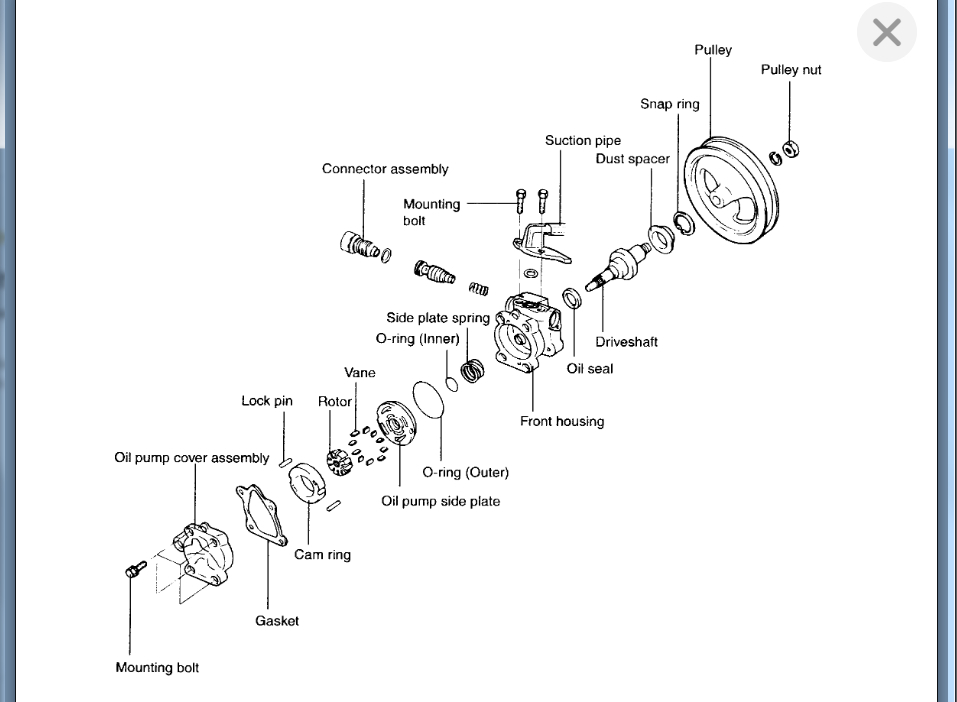

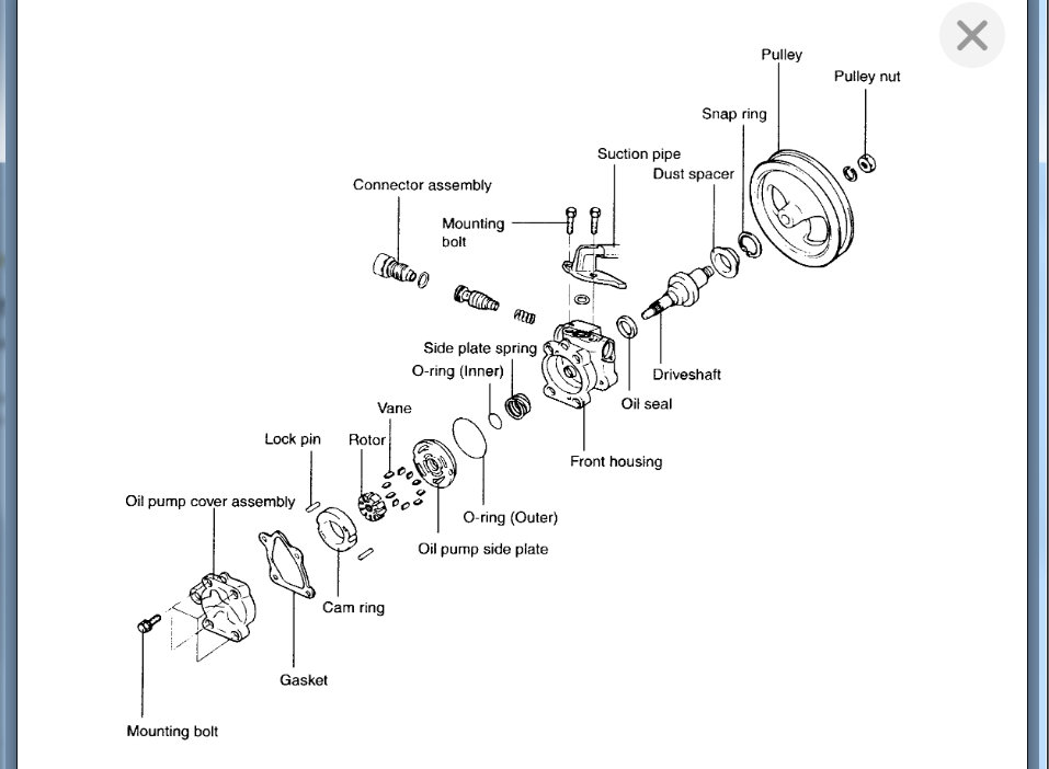

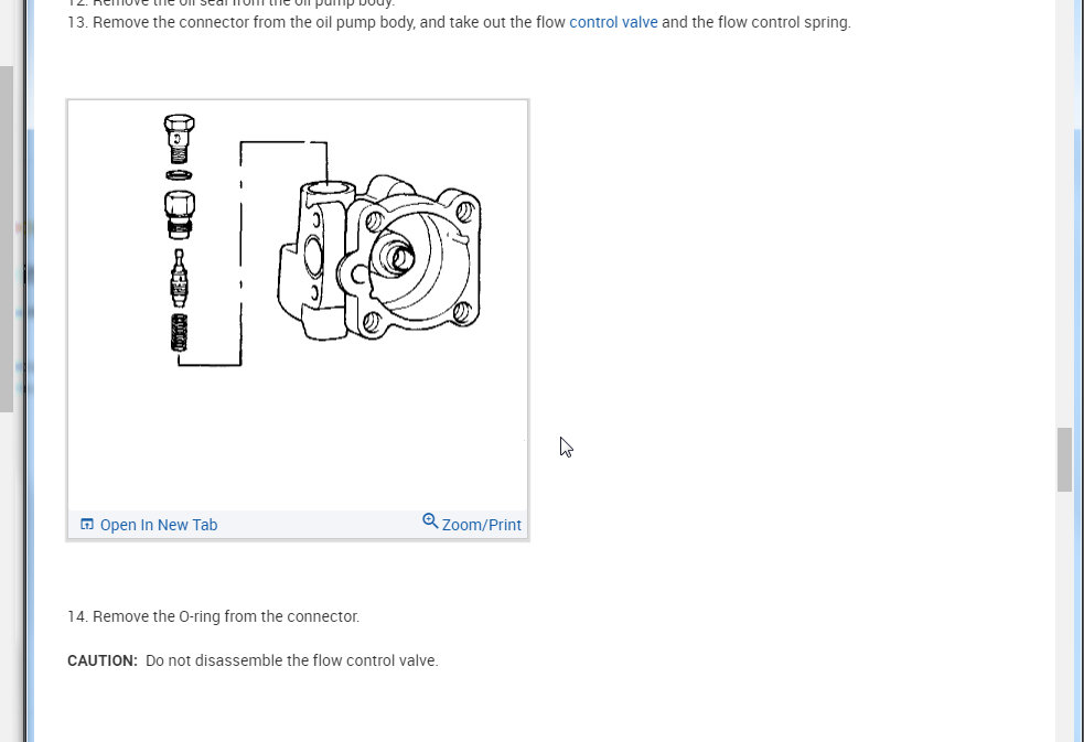

I have had power steering problems with the car since I bought it never really had it and if it did it was choppy and would come and go I took the pump apart and did what I would normally do and check on the components and they all seemed to be in good repair put it all back together and I only have power steering when the car is reved at 3000 rpm or more plz help
