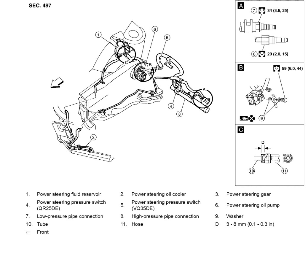

Pushing fluid out the reservoir cap when I cut the car off from being hot or warm everyday when I start the car it turns smoothly hear no noises drive 2 mi down the road and if I try to turn the wheel it will whine and when I cut the car off it will push my fluid or some of the fluid out through the reservoir cap cut it off for 5 minutes it's right back to smooth turning no noise. Drive couple miles down the road same thing you hear whining noises when you try to turn it gets hard to turn cut the car off and it tries to push the power steering fluid back out through the reservoir no visible leaks under the car or from my lines no visible leaks around the reservoir just pushing it out the cap.
