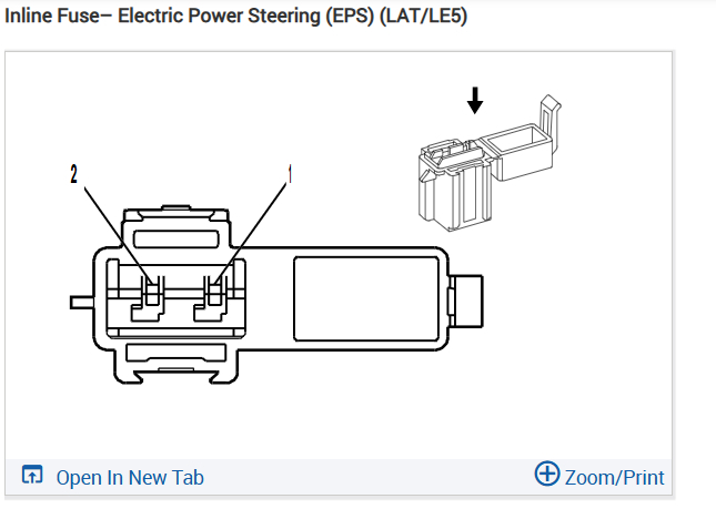

Yep, this is the classic power steering motor failure, but you should check the 60-amp fuse in the "inline" fuse holder near the power steering module. Check out the images (below). Let us know how it goes.
