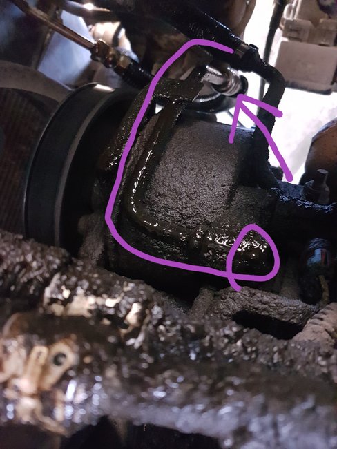

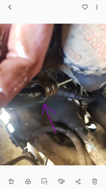

Pretty sure I found where the leak is coming from, the first picture is from underneath and i can follow the path the fluid takes and where it would drip from. On the second pic, when I pulled back the protective plastic tube I could see the power fluid rush to fill the gap between where the hose and steel meet when I manipulated the hose. Maybe that 'pop' sound was nothing related to this? Also, no groaning so I'm hoping I haven't damaged the pump. Or is where my leak coming from something that is attached to more = more money? Really bad timing so if at all possible I'd like to tackle this one myself.

Okay. No groaning is a good thing. Also, that could very well have been the noise. This system is under a lot of pressure especially when turning so if something lets go it can sound like a balloon popping.
All we can do is fix what we find broken and then retest. The frustration comes in (and it gets expensive) when we can't find anything and it still doesn't work. That is when people start guessing at parts or take it to a repair shop. Either way, it is more expensive.
I would just go ahead and repair what you found and retest it.

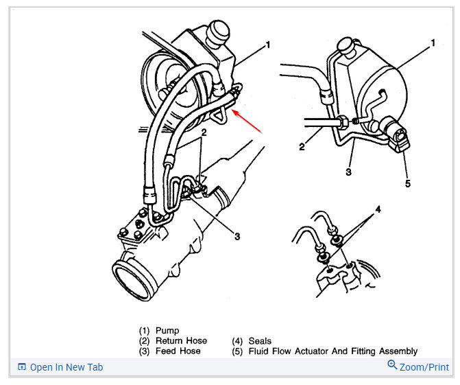

Looks like that is the feed line that wraps around the pump. I included the diagram to try to determine this. I would follow the line down and see where it connects to the steering gear. If it is in the same location shown then that is the line.
