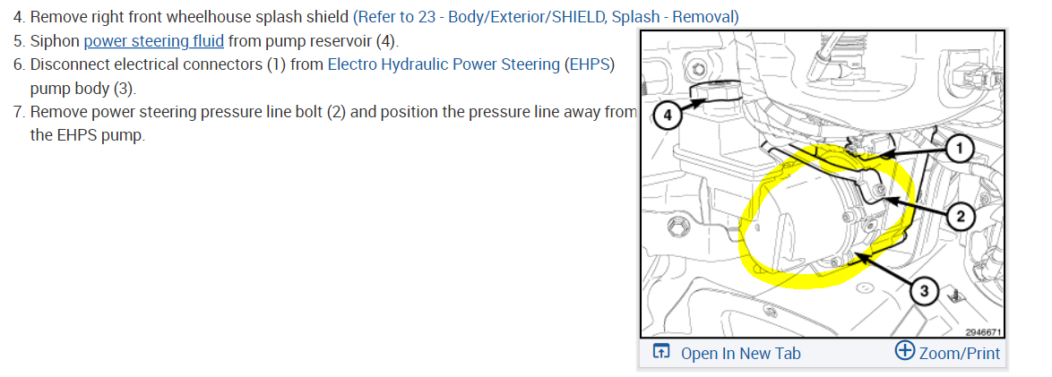

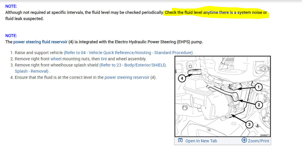

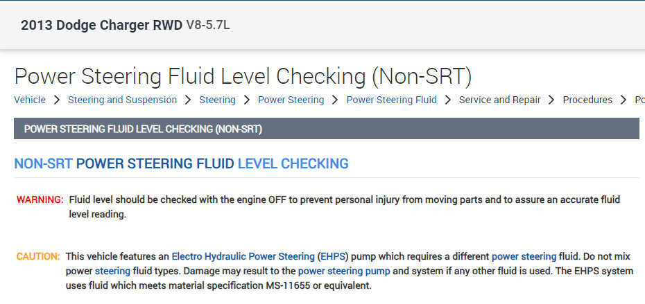

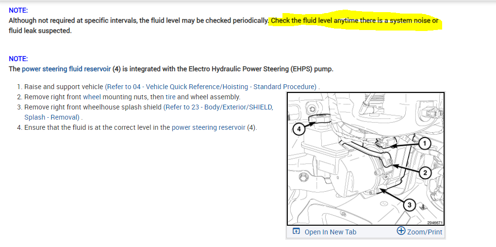

I did hear it. To me, it sounds like it may be low on fluid. Although this vehicle has electric power steering, there is still fluid in the system.
I attached directions below for checking the PS fluid. It is a little bit of a pain, but it can be done.
Note: If this is an SRT model, these directions are not correct. Let me know if that is the case.
joe
See pics below.

And the fluid seems to be where it needs to be.

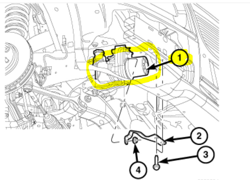

Sorry for the delay. I wanted to get clarification on my thoughts of the sound before contacting you.

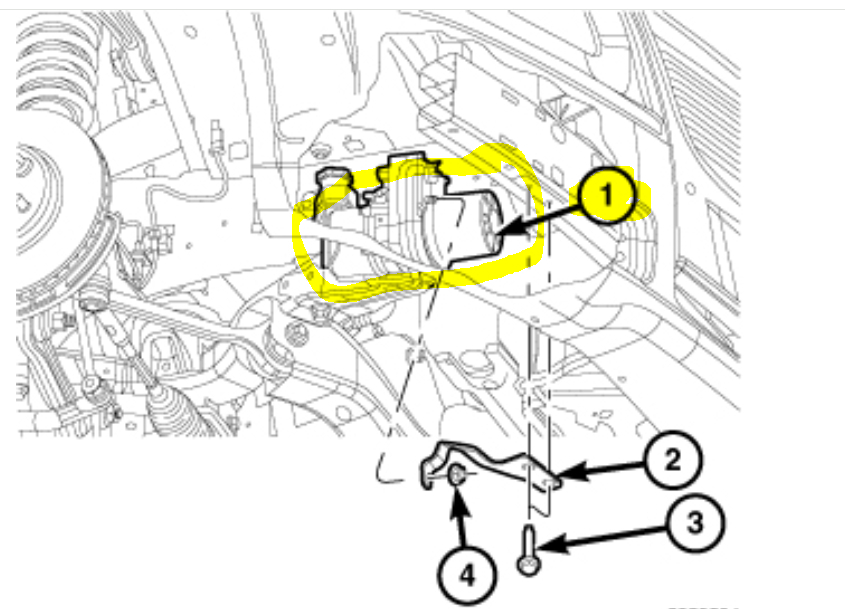

Both the site owner and I feel this is the electric P/S motor that is making the noise. It is referred to as the EHPS, electrohydraulic power steering pump.
I attached two pics below of its location. Confirm that this is where the noise is coming from and let me know what you find.
See pics below.
Aug 16, 2024 at 9:12 PM
SKOOTER28
  • 98 POSTS
Yes, that’s exactly where the noise is coming from I sent another video of me right at it recording the noise.

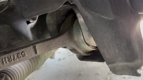

One more thing, while I was under there, I saw this and it looked like it was going bad i know we replaced the other side but not this one.
Aug 18, 2024 at 3:06 PM
It does look like the rubber bushing is starting to fail. You should likely replace it while you have things apart.
Let me know if I can help and how things turn out for you.
