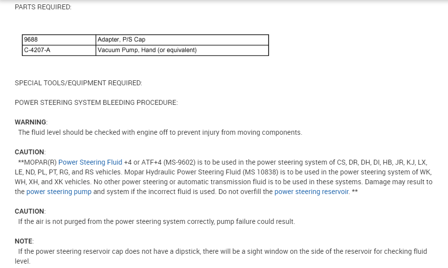

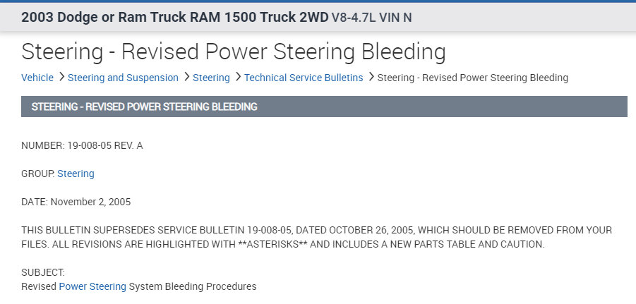

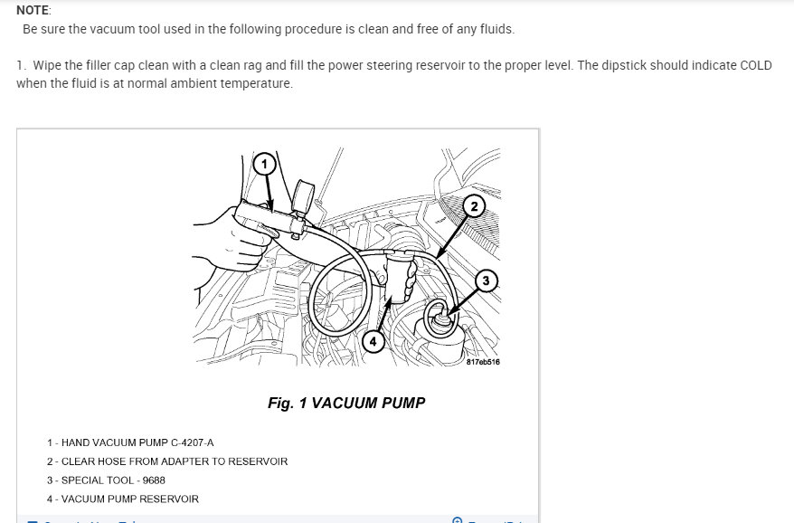

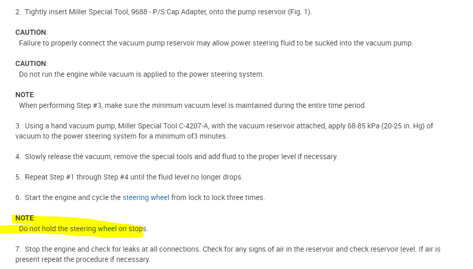

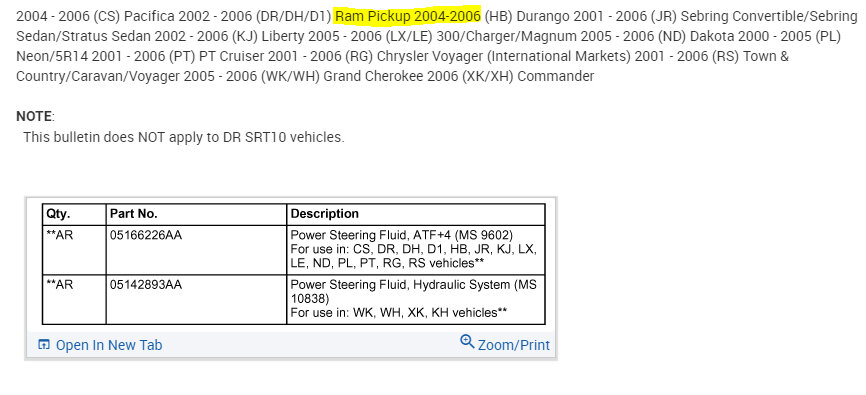

If you are hearing a whining sound, it sounds low on fluid. However, I did come across a technical service bulletin indicating a specific way to bleed the power steering fluid of air.
If you look below, I attached the bulletin. Take a look at it and let me know if this is something you feel comfortable performing.
joe
See pics below.
