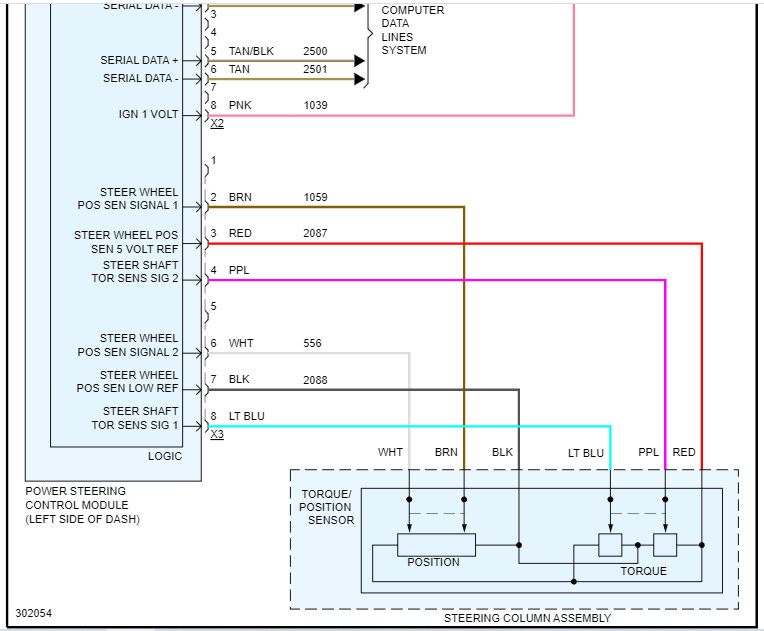

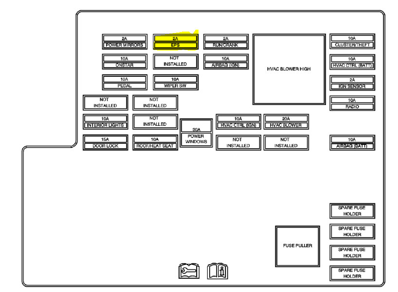

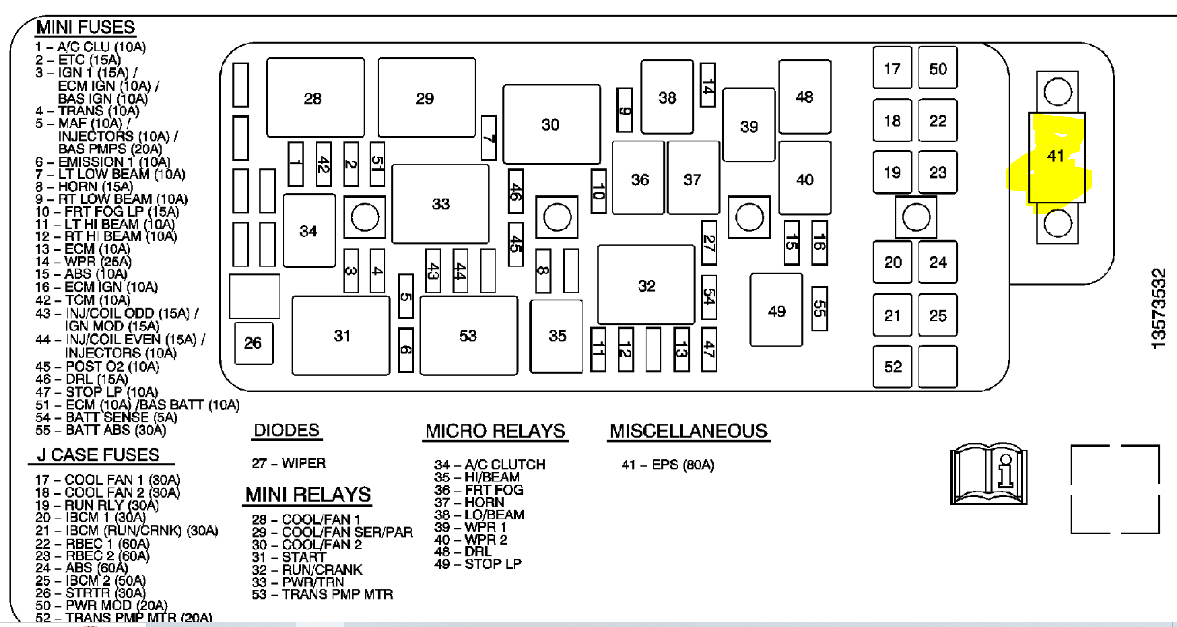

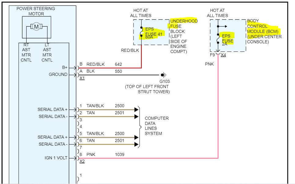

There are two fuses to check. Both supply power to the P/S control module.
I attached the wiring schematic below, so you have a reference. See pics 1 and 2.
Pics 3 and 4 are the fuse boxes. Pic 3 is the under-hood fuse box. Pic 4 is in the vehicle.
When you check the fuse, it is also important that you confirm there is power to it.
