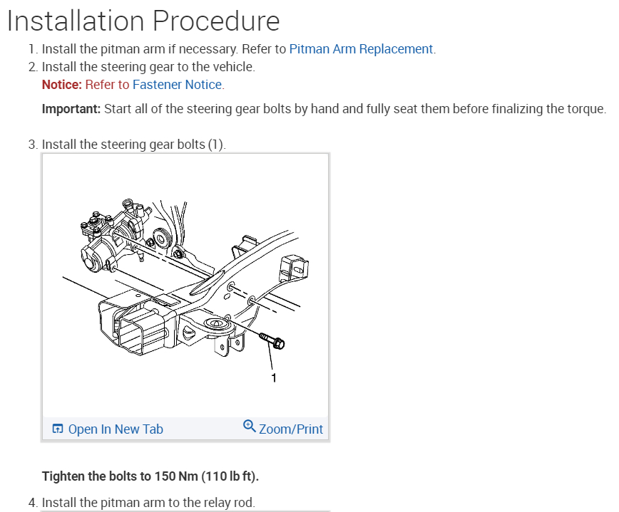

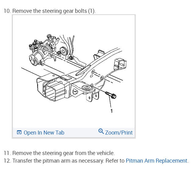

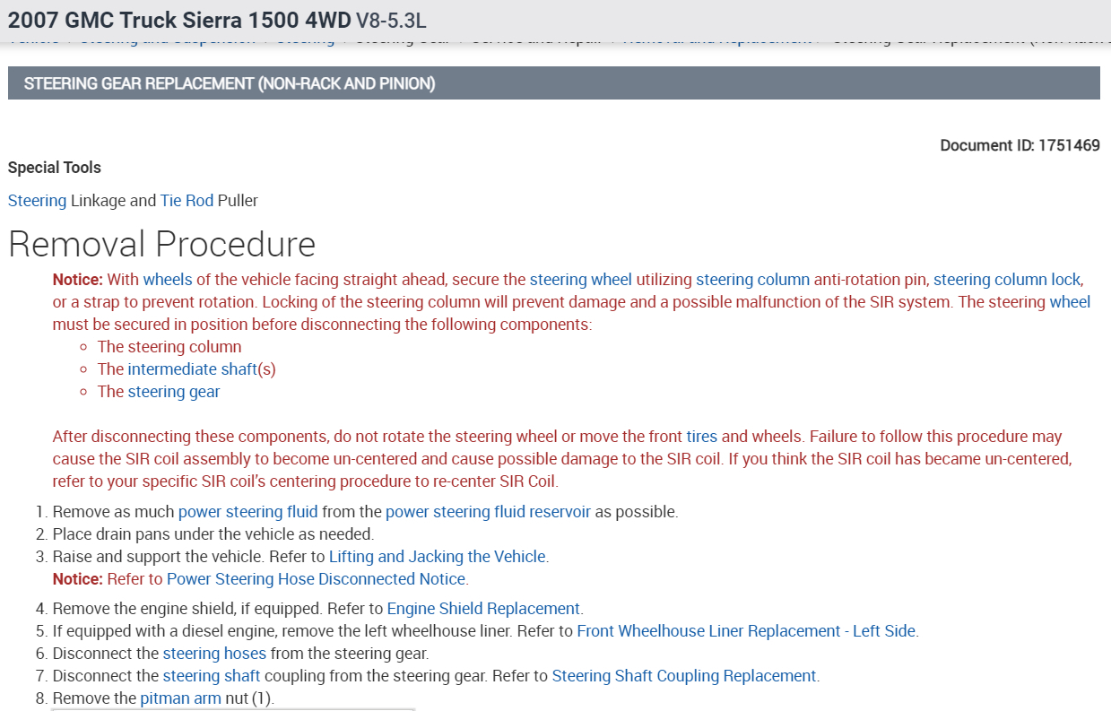

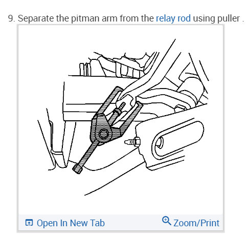

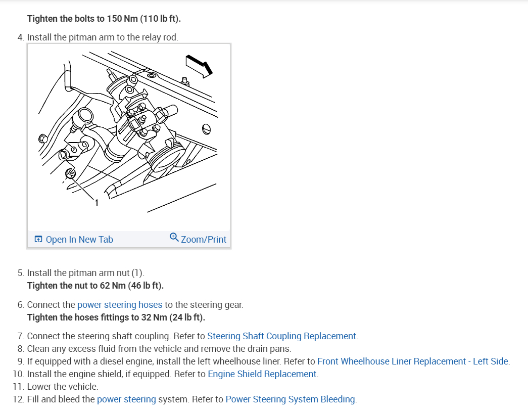

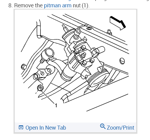

This happens when the steering box goes out here is a video which shows the job being done on a similar vehicle, but the process is the same, also there is the instructions to do the steering box swap in the images below.
https://youtu.be/KKeFqHLuRQ0?si=-W1MWGYDt42huXWq
Check out the images (below). Please let us know how it goes
