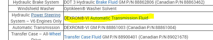

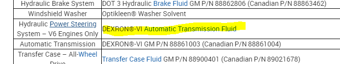

Also, what type of fluid was used to refill the pump/reservoir? It calls for Dexron VI transmission fluid. See pic below.
See pic below.

Oh my! I didn't know that i put regular power steering fluid in there, not Dextron 6. will it burn up my motor? i haven't driven it more than 40 miles.
