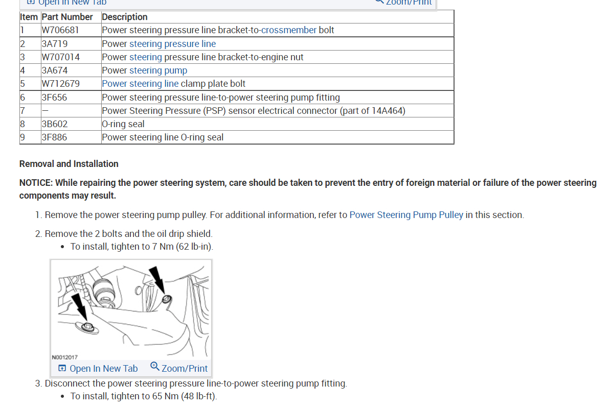

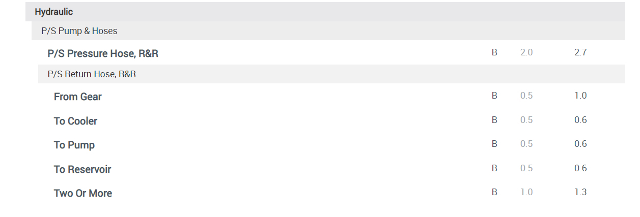

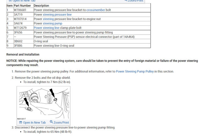

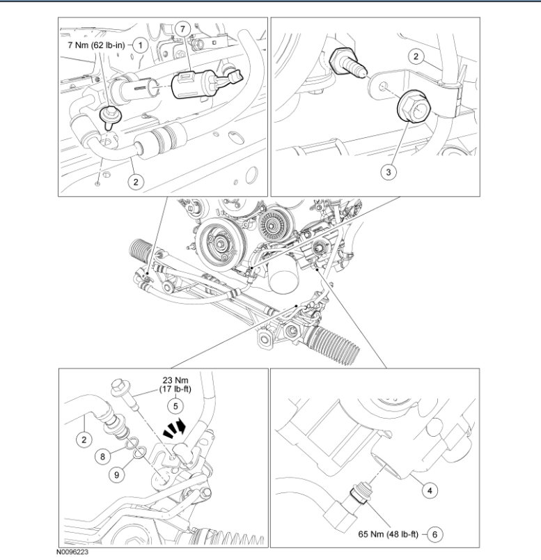

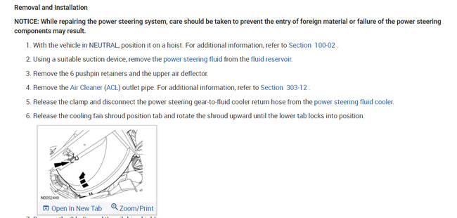

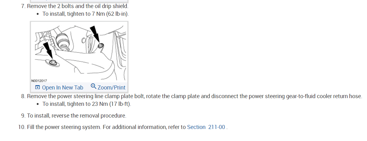

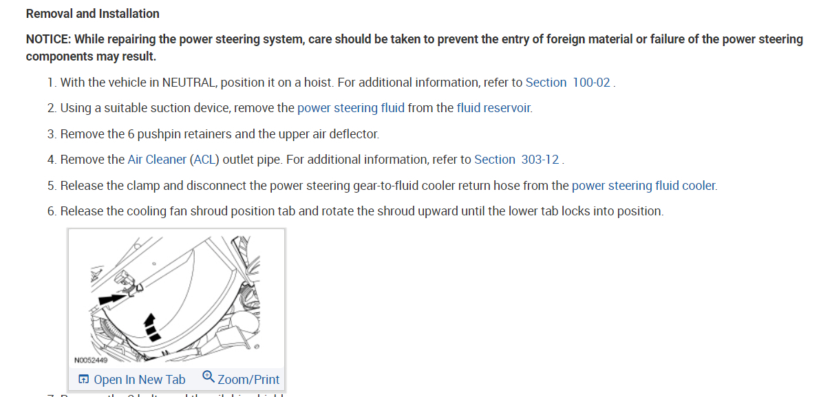

I need to know how long to remove and replace the power steering line. on the truck listed above 4x4.
Feb 8, 2019 at 7:11 AM
Good morning,

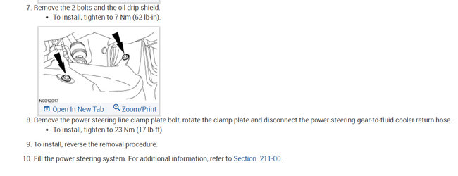

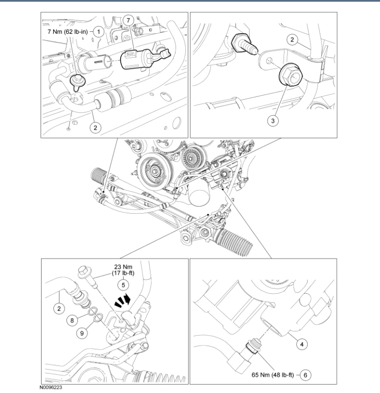

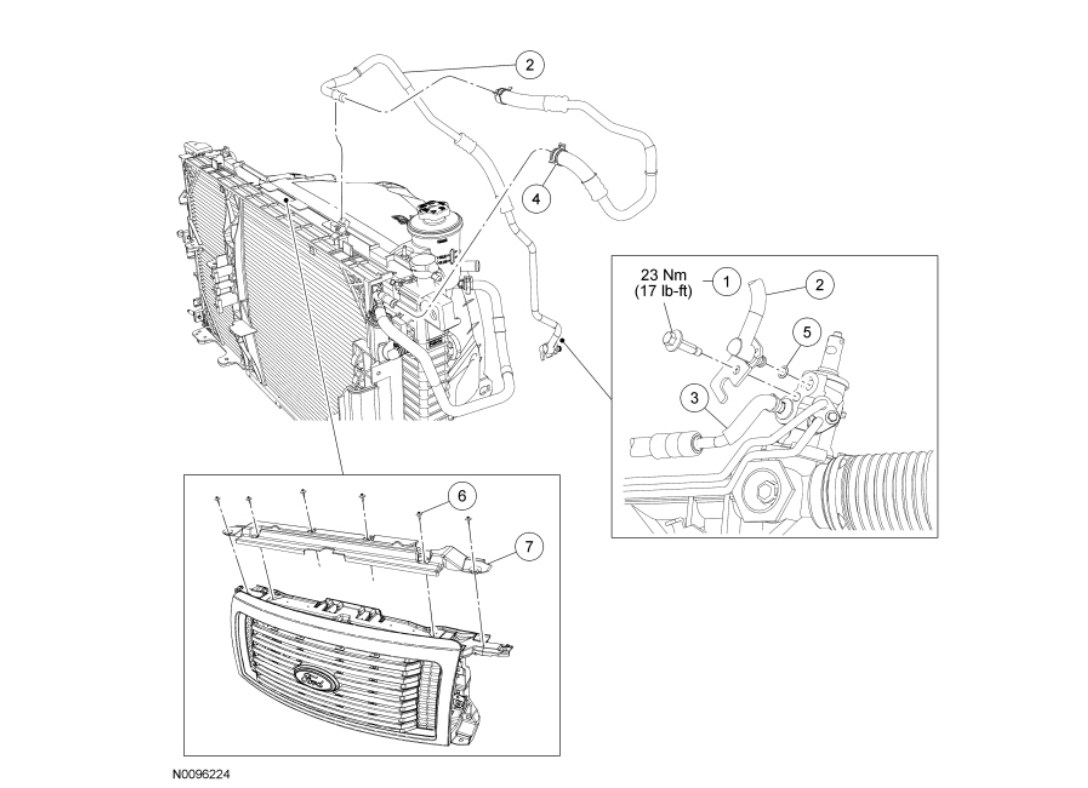

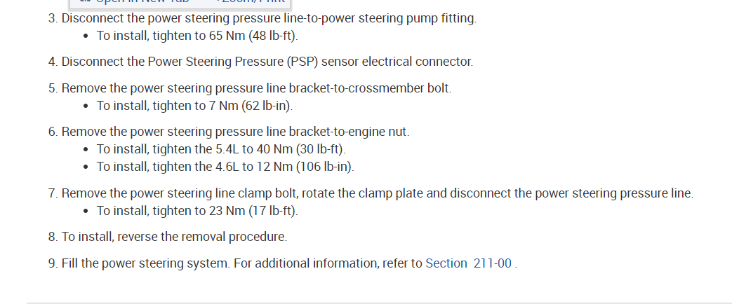

I attached the procedure for both the pressure and return lines.
I would flush the system of all the old fluid when complete. I attached a guide below for you.
https://www.2carpros.com/articles/power-steering-fluid-flush
I also attached the chart for the times for the replacement as well.
