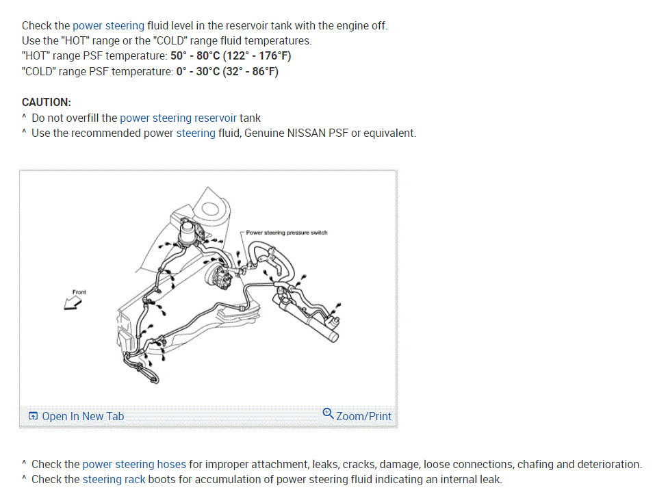

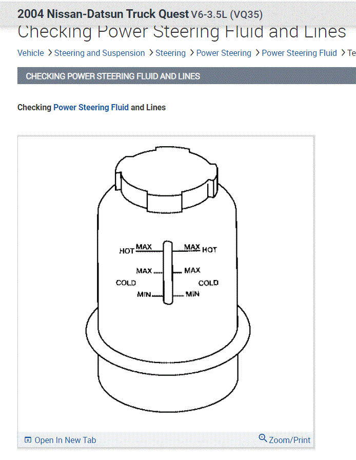

Since there is no noise, I suspect the fluid level isn't an issue. However, please check it and confirm its condition is okay. Also, inspect the hoses to make sure there are no leaks or damaged hoses. See pics 1 and 2 below.

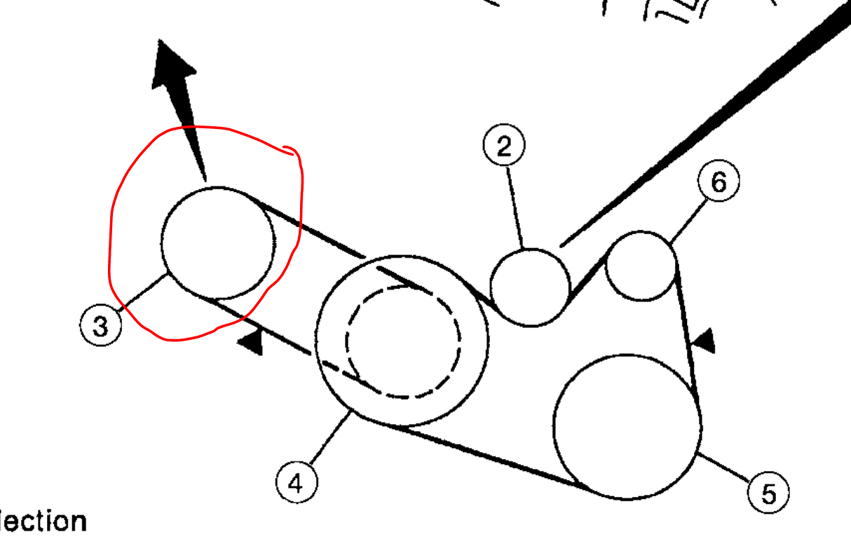

Next, this vehicle has a separate power steering belt. Check to make sure it is on, not loose, and not damaged. Make sure it is tight as well and turning the pump. See pic 3 for the position. I circled the pulley.

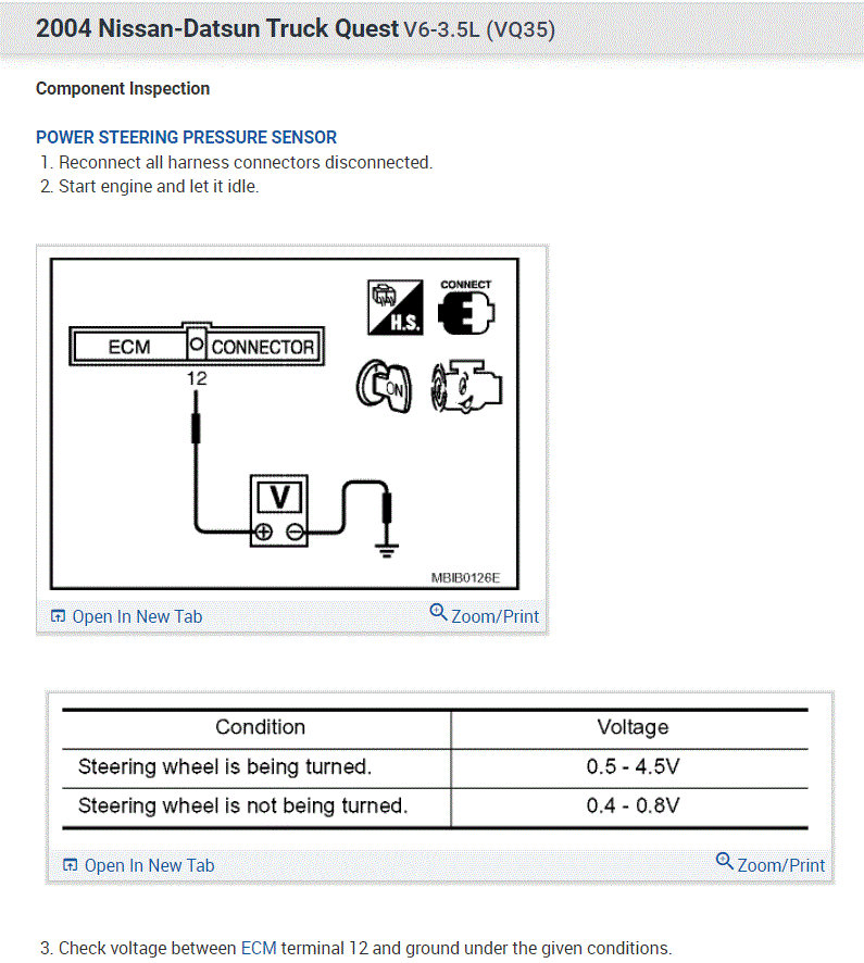

If that is good, then we need to check the pressure sensor. See pic 4 for testing.

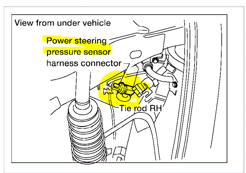

The sensor is located near the rack and pinion. See pic 5 for location.
See pics below.
