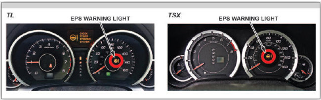

And/or the ESP light on?

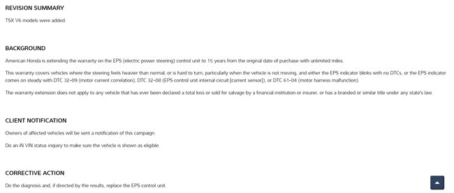

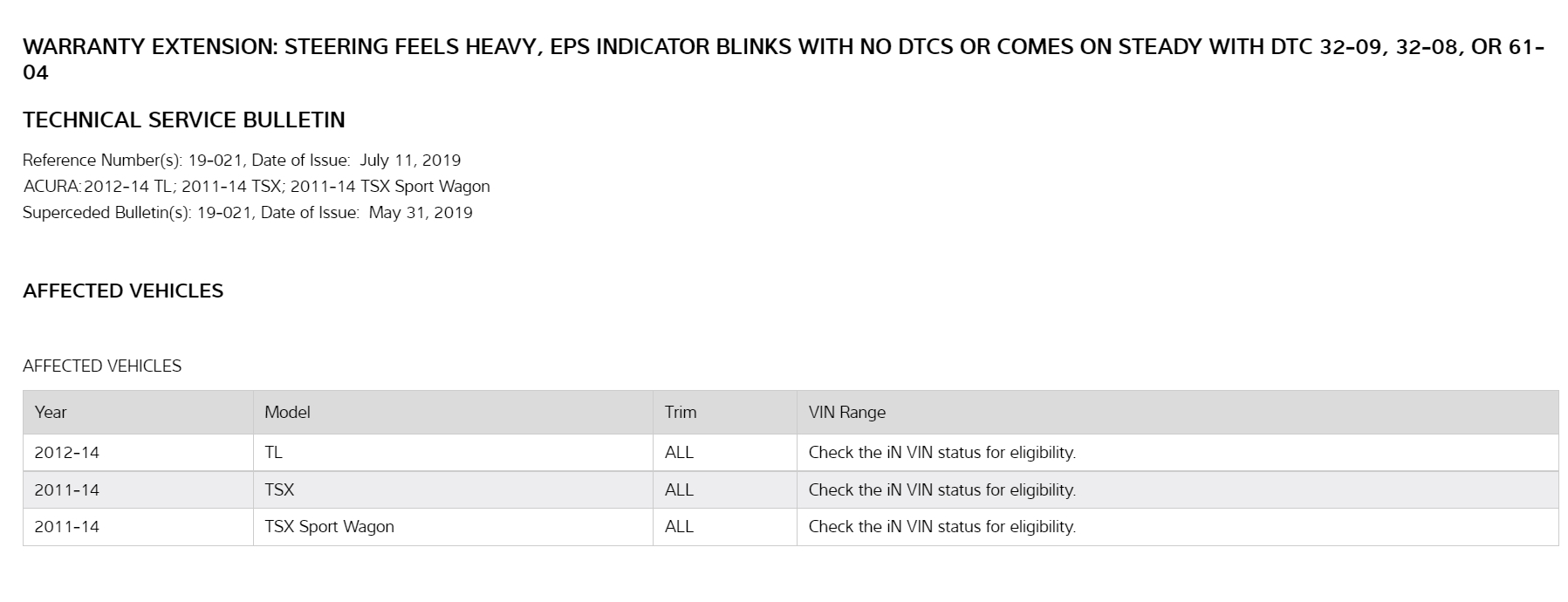

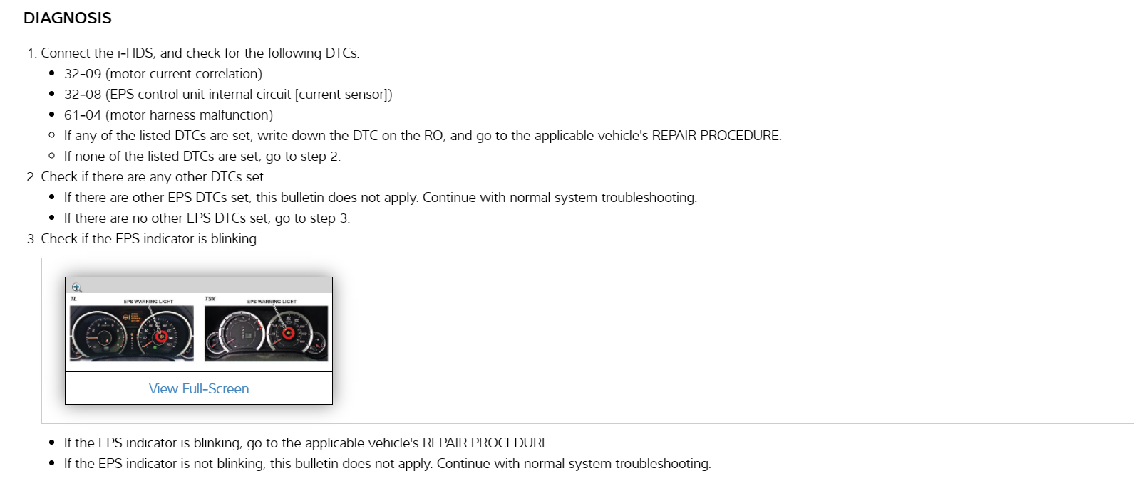

There is a Technical Service Bulletin for these types of issues.
It says they are extending the warranty for the Electronic Power Steering control unit 15 years from purchase date.
