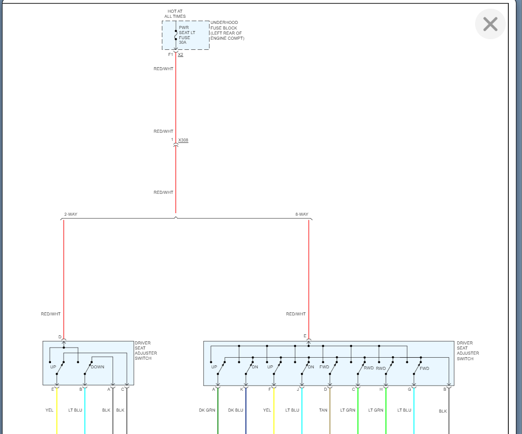

If this was not an issue prior to replacing the switch, then I suspect the replacement switch that you have is faulty.
The way to prove this is we need to go to the switch and check to find out if there is voltage coming from it. Basically, if the switch is not being pressed it should be an open circuit. So, if it is an open circuit when the seat is moving then the motor is shorted.
However, I fully expect that the issue is going to be the switch that was used has an issue.
Here is a guide that will help with this testing:
Plus, here is a guide that will help with replacing the switch if you want to attempt it yourself:
https://www.2carpros.com/articles/seat-position-switch-replacement

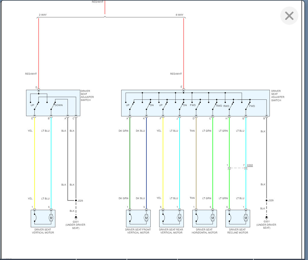

Please see the wiring diagram below. Let me know what questions you have but we need to see what the voltage is on the down circuit when you are not pressing the button, but the seat is moving.
