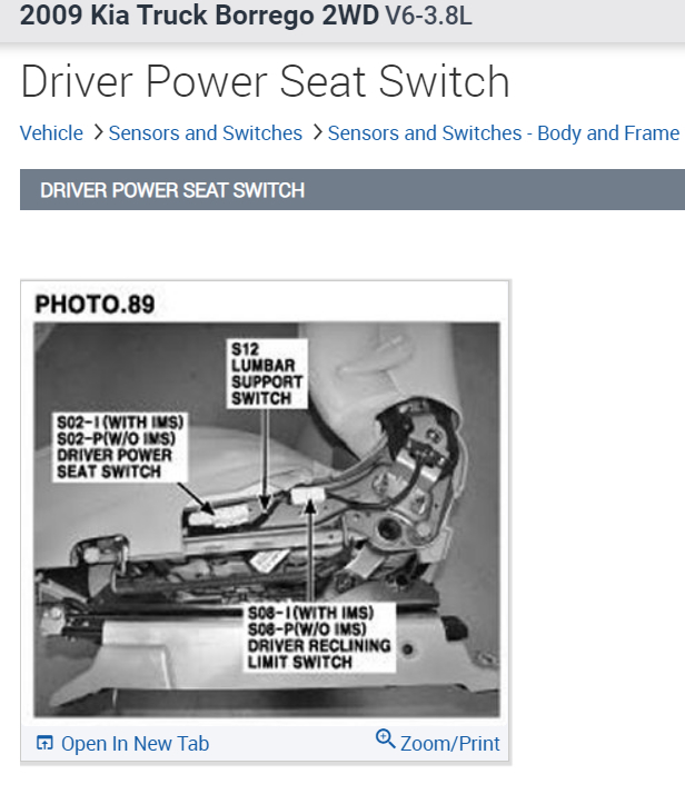

For some reason they are not listing an adjuster switch so you might need to find a used one. Here is a generic guide to help with the steps and specific information for your car in the images below:
https://www.2carpros.com/articles/seat-position-switch-replacement
Control Switch 0.6 hours labor.
