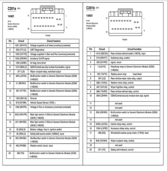

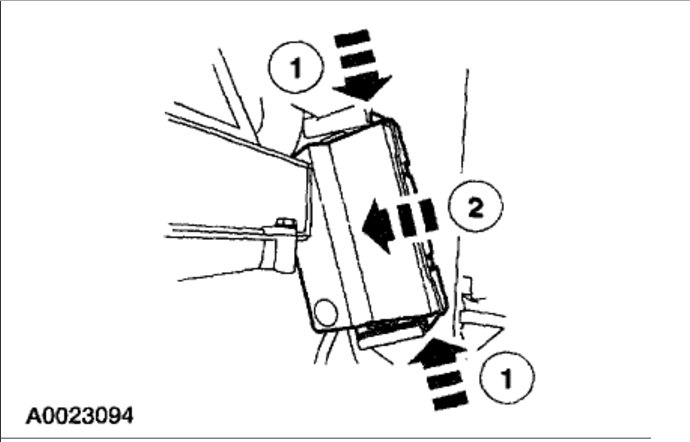

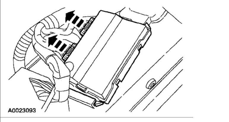

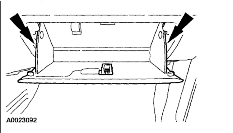

It sounds like you have a GEM that is going out.
Here is its location so you can change it out.
Here are the GEM location diagrams (below).
Please let us know what happens so it will help others.
