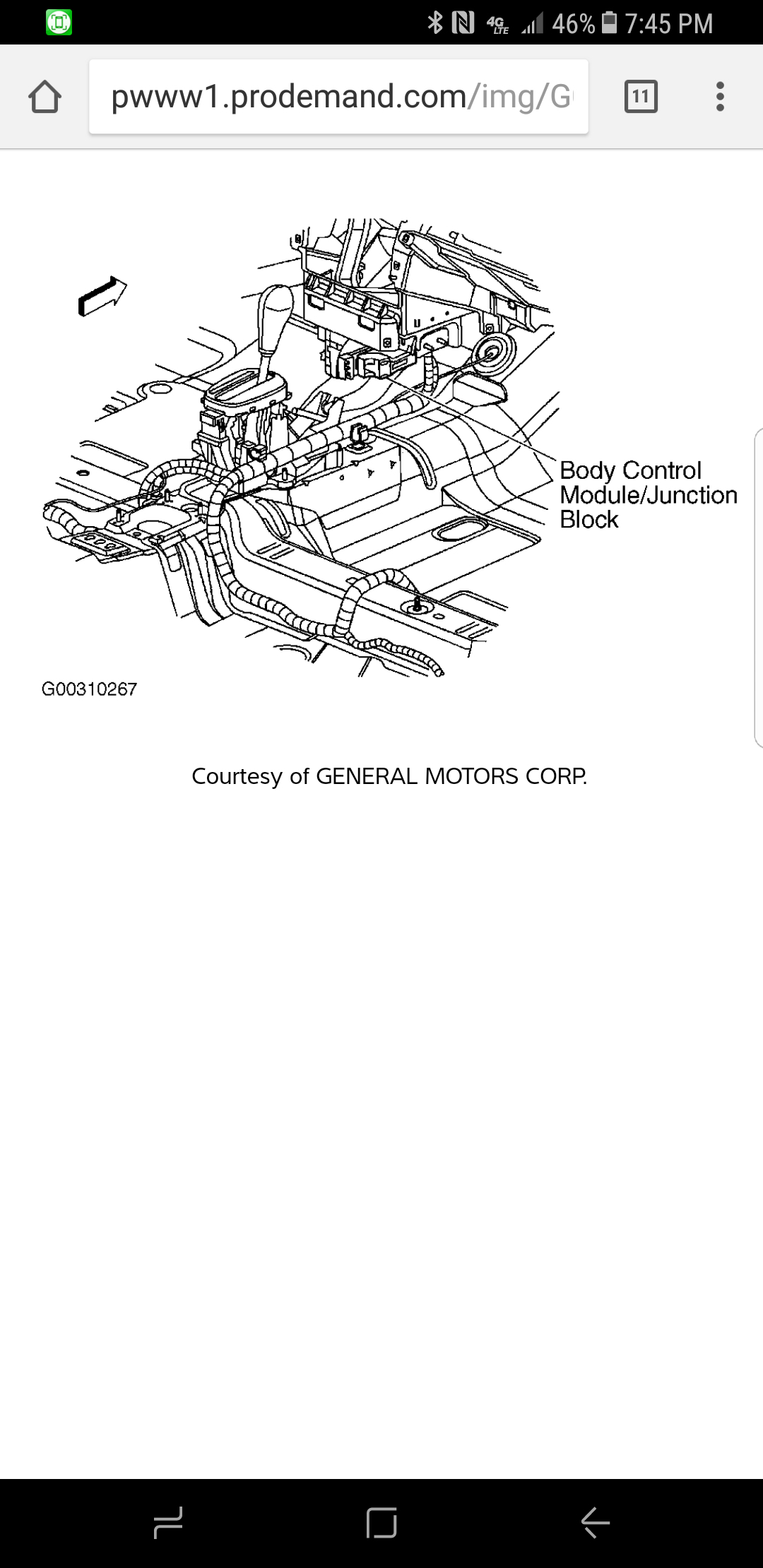

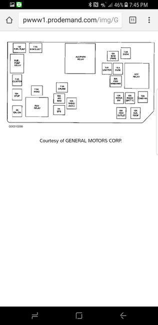

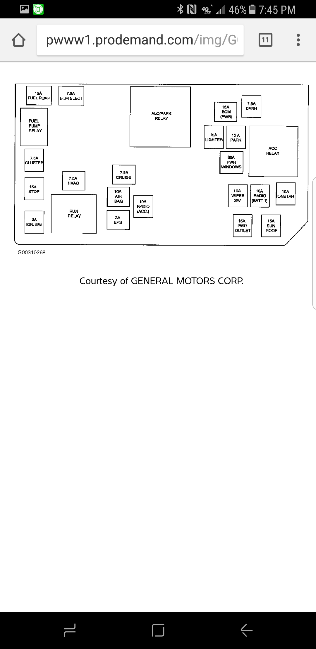

SATURNTECH9
  • 30,869 POSTS
The fuse labeled lighter is the fuse you want to replace, it is a 15 amp mini fuse.
Jul 19, 2017 at 7:47 PM
BRADEN MCCANN
  • 4 POSTS
Thanks so much it worked perfectly!
