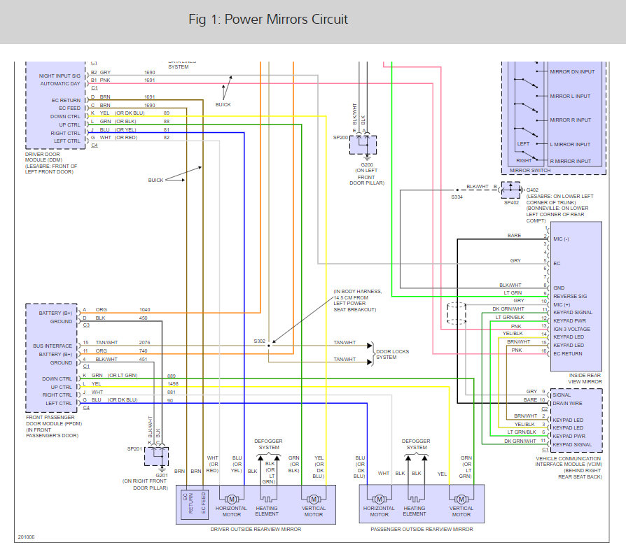

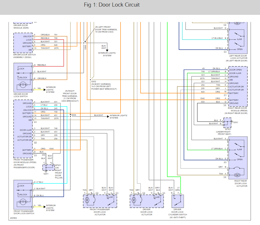

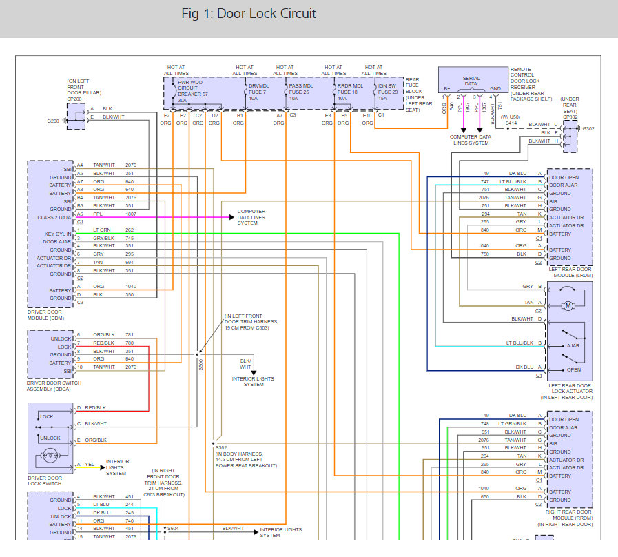

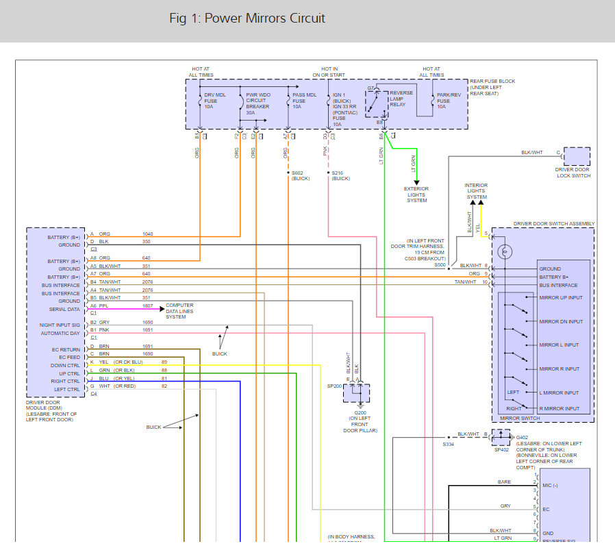

My power locks windows mirrors stopped working awhile back and my lights on the interior of my car only work when they want to and tend to stay on for a long time after I get out if they turn on. I checked all of my fuses and none of them are bad. Thank you in advance for your help.
Oct 21, 2018 at 5:14 PM

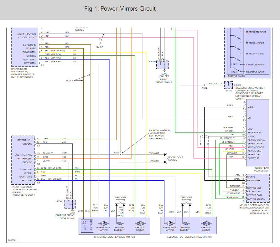

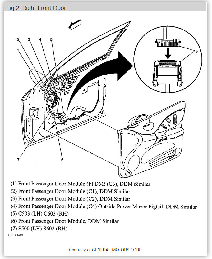

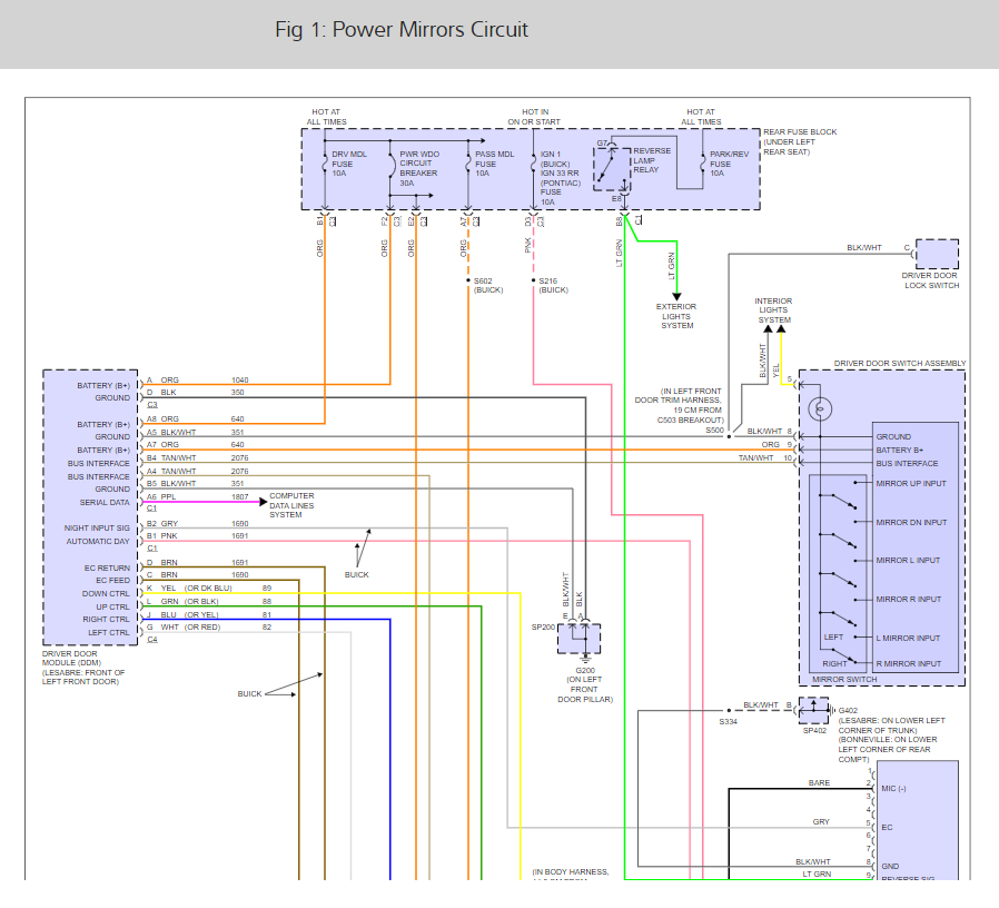

It sounds like the drivers side door module has gone out which is common here is the wiring diagrams so you can see how they system works and the DDM location. I would try to find a used one and plug it in to see what happens. If you need to get a new one it will need to be initialized by a shop should cost about $120.00 to have it done.
