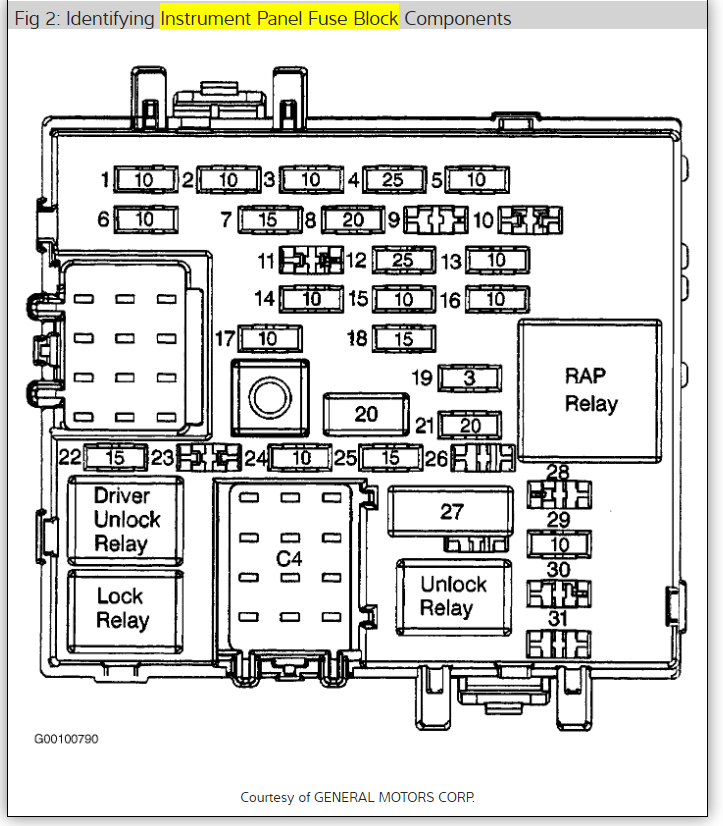

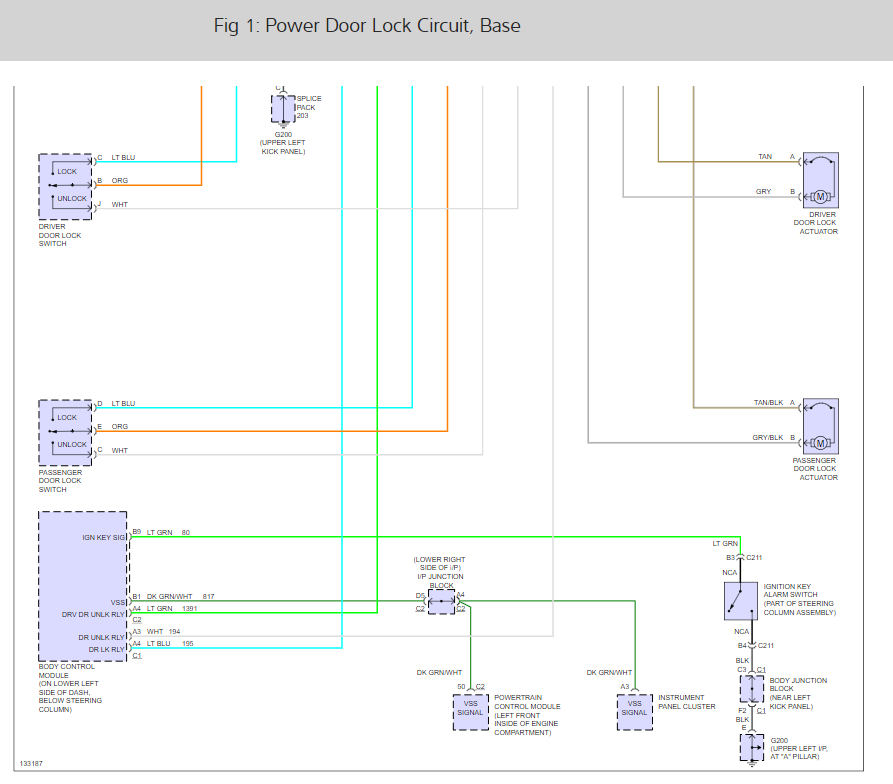

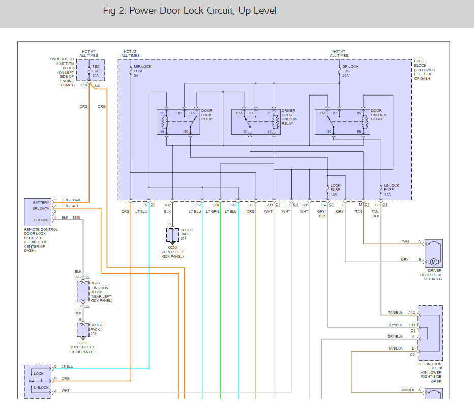

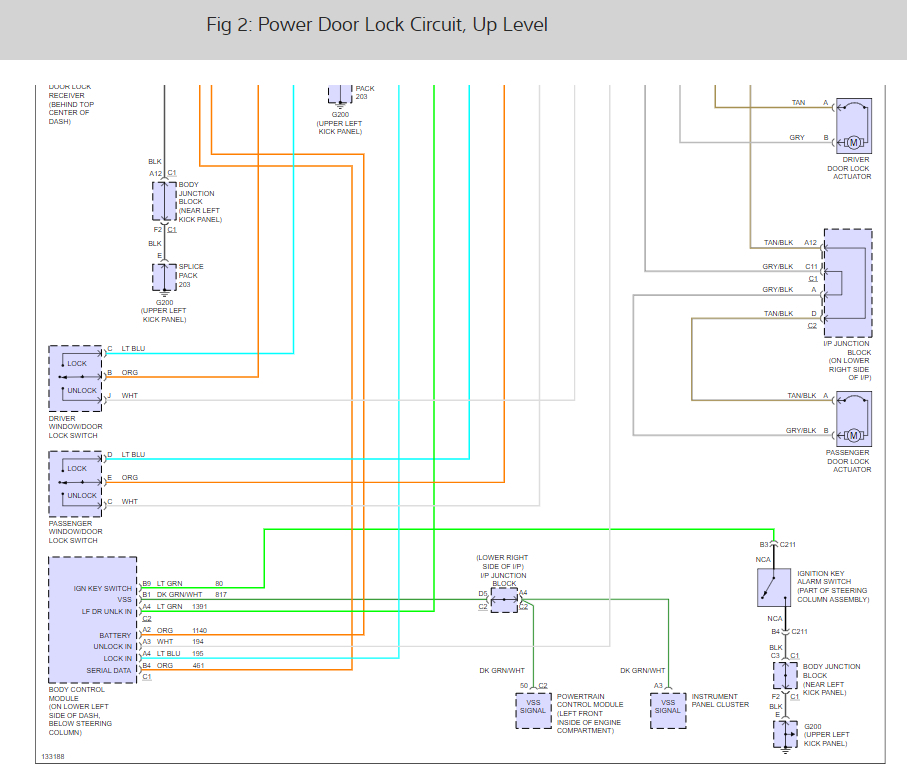

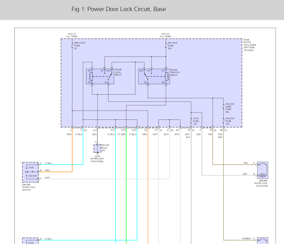

It sounds like the drivers door lock relay is not working. Here is a guide to help you test it and the door lock wiring diagrams so you can see how the system works and the location of the relay as well:
