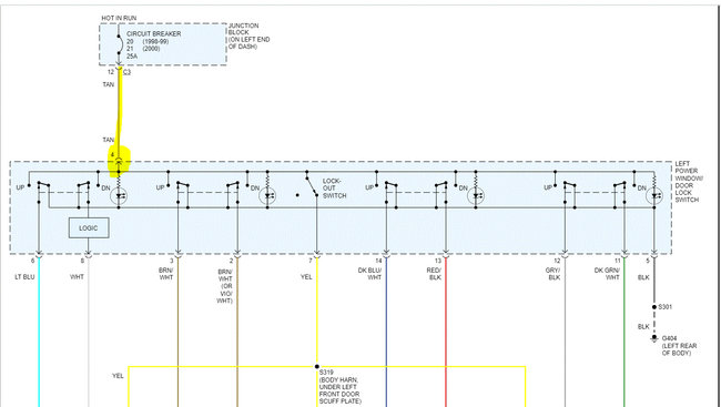

I put in a new driver side window regulator after doing so now using the driver side control of windows and doors they don't work. Nor do the windows work from their respective switches?? Where to begin troubleshooting??
Aug 25, 2020 at 7:12 PM
The system is protected by a circuit breaker, so it won't be a blown fuse. The circuit breaker can fail, but it should reset after some time.
I suspect that something is loose in the main switch wiring or the ground in the door. If you look at pic 1, it shows a tan wire to the main switch (driver's door) which basically sends power to all switches and windows. I need you first to confirm there is nothing loose on the connector. If everything appears good, then disconnect the connector on the main switch, locate the tan wire, and see if power is available from the tan wire in the pic.
Do this and let me know what you find or if you have other questions.
