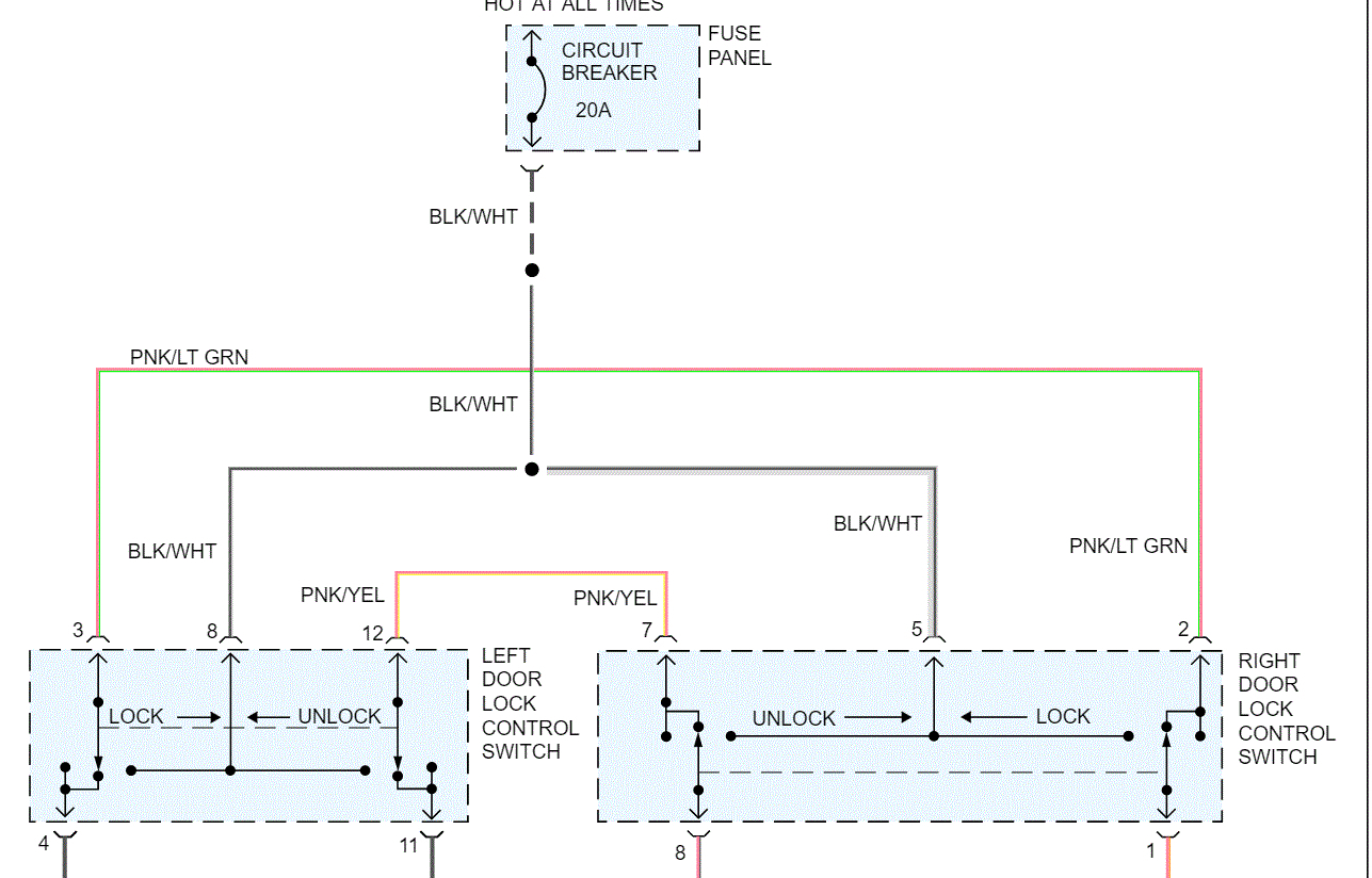

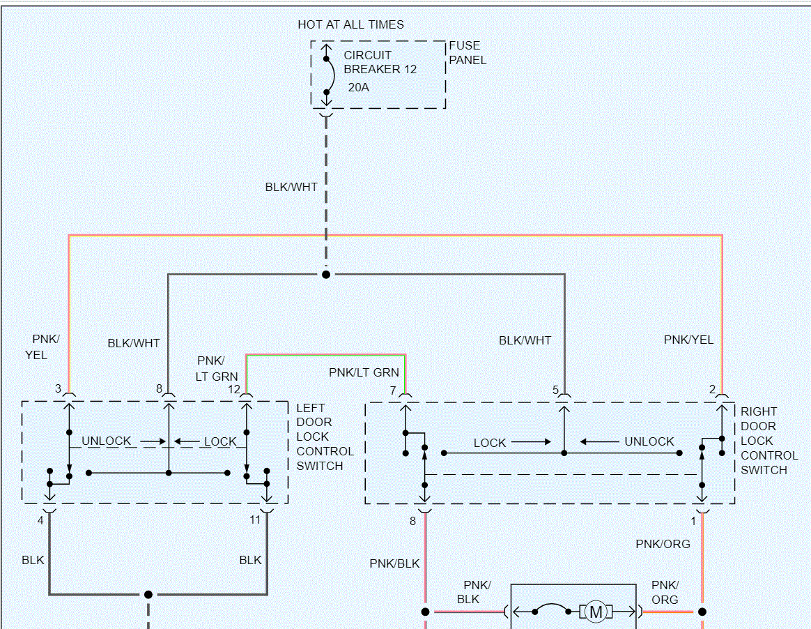

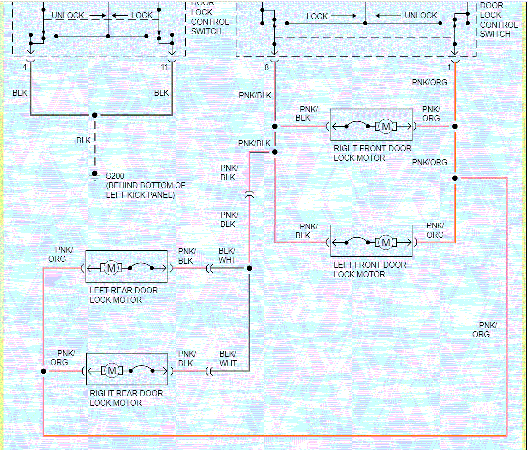

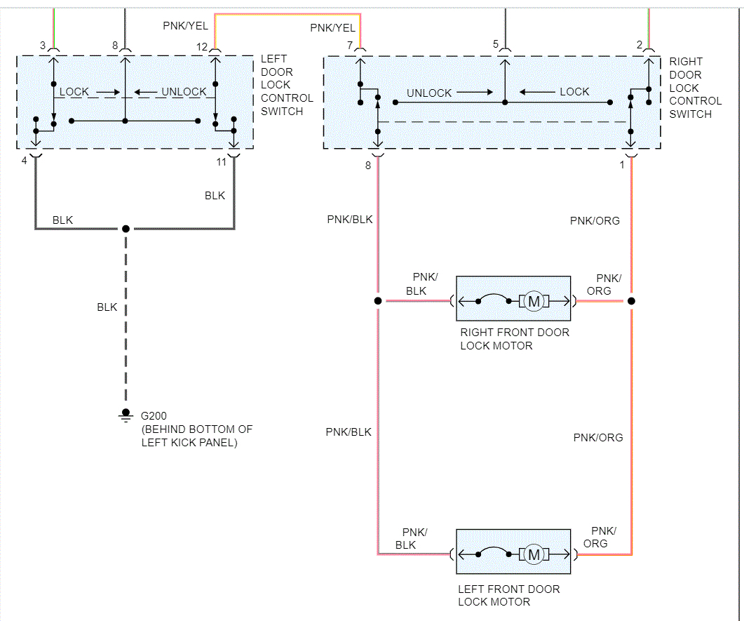

What I am providing are wiring schematics for the door lock system. Not being there with you, I can't see what has been done. However, look through these pics and see if they help.
Now, I don't know if you have a regular cab or crew cab, so I will provide schematics for both. The first two are for a regular cab. Pics 3 and 4 are for a crew cab.
It really isn't a complex system. However, when someone cut things up, that can make it difficult. Here are a few links you may find helpful when testing:
