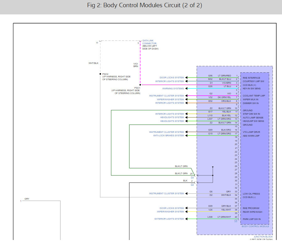

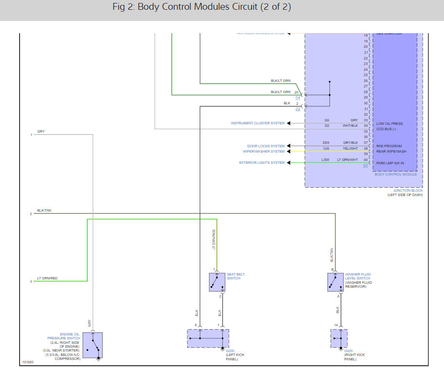

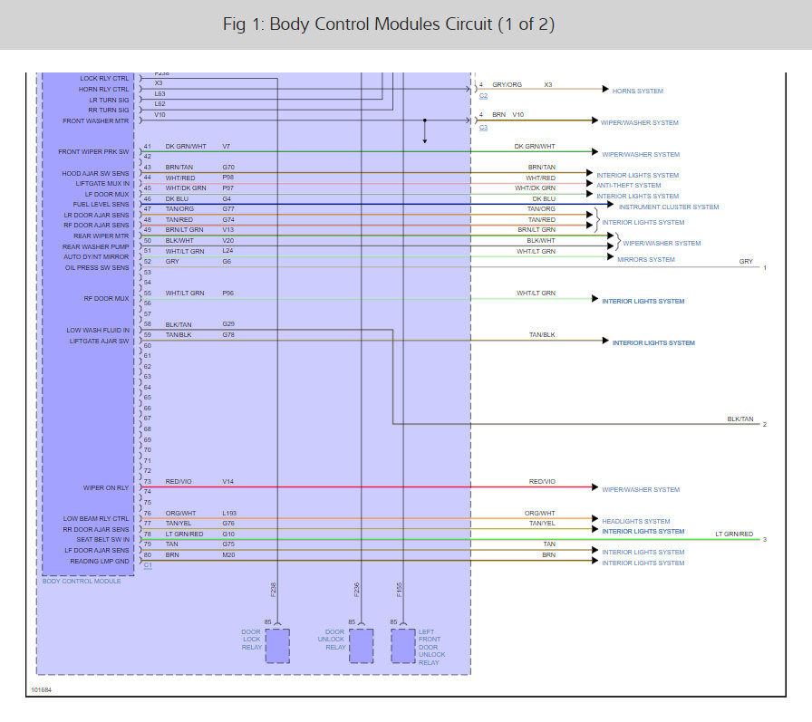

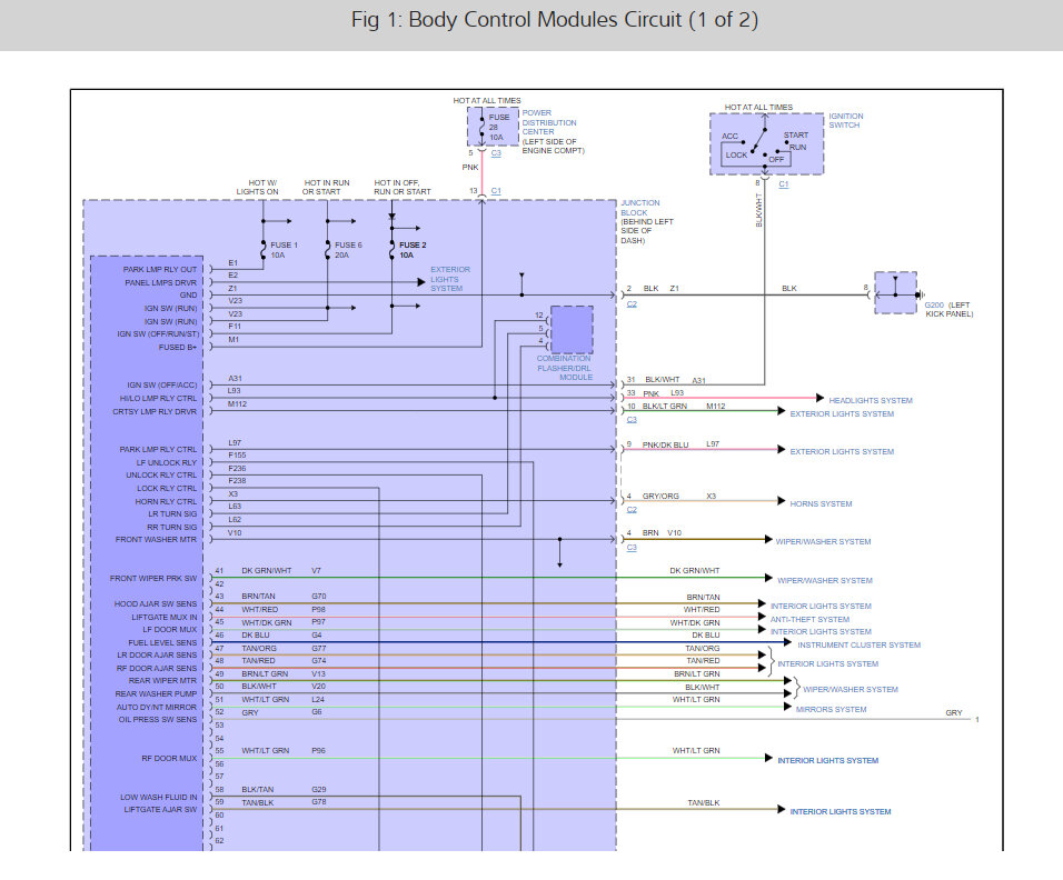

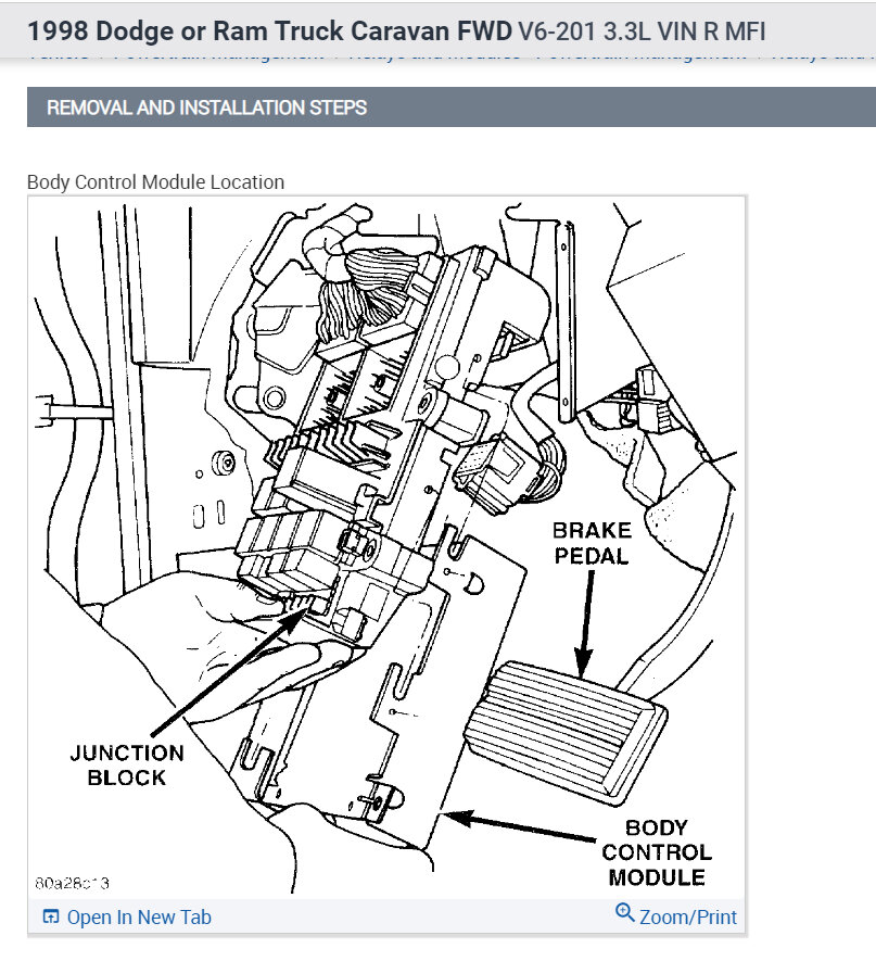

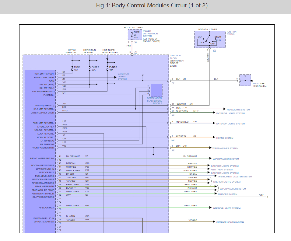

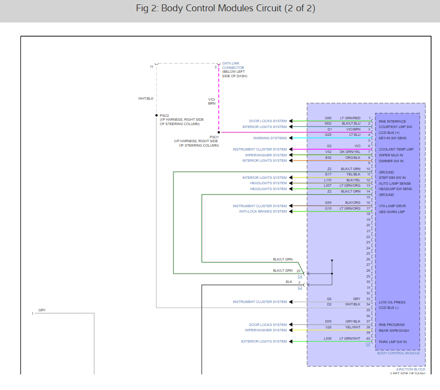

This sounds more like the BCM has gone out, but we can check for power and test the grounds before replacement. here is a guide to help and the location and instructions on how to replace the unit in case you need it:
Here are the BCM wiring diagrams so you can see which wires to test for power and ground. If the fuses are okay (test with ignition on) I have left the location and instructions on how to change out the BCM, you can get a preprogrammed unit by searching Google or Ebay. Check out the images (below). Please let us know what you find. We are interested to see what it is.
