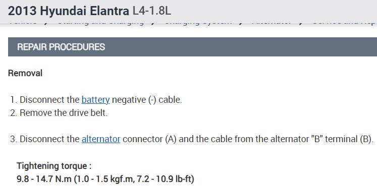

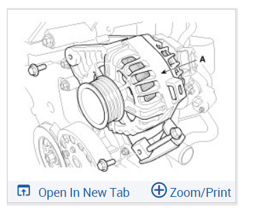

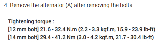

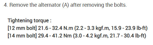

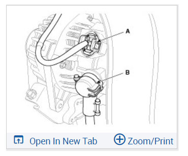

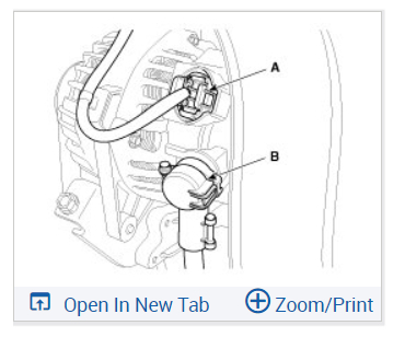

If the battery light is on, then the alternator is not charging the battery. here is how to change the alternator out in the images below. Check out the images (below). Let us know if you need anything else.
