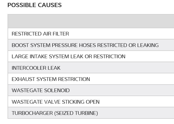

Ok I'm getting a code p2262 turbo boost pressure not detected .....what needs to be done help
Jun 25, 2017 at 5:30 PM
HMAC300
  • 48,601 POSTS
see pic for possible causes a lot of these you can check out your self.
