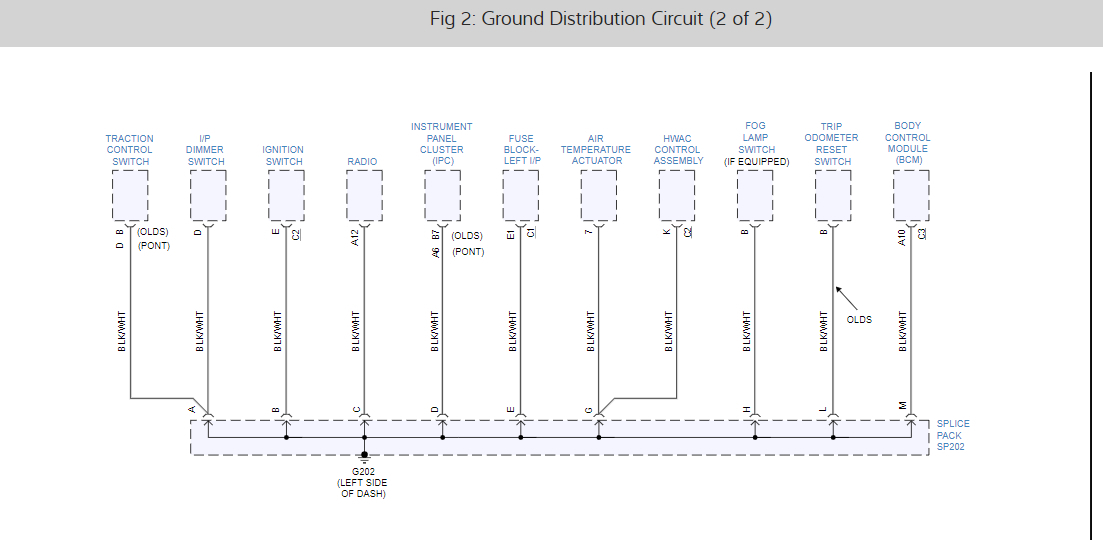

Have a power draw. Just started pull the bfc battery fuse 10 amp on driver side dash fuse location stops 90% draw this is on maxi fuse l/h bec battery 2. then pull fuse radio battery on passenger side to stop all voltage draw this is on maxi fuse r/h bec battery. Now my question is, where are the ground location at for these so i can check and make sure they are good? Best i can find is g202 but i do not know where that is located at or if i am even on the correct one.

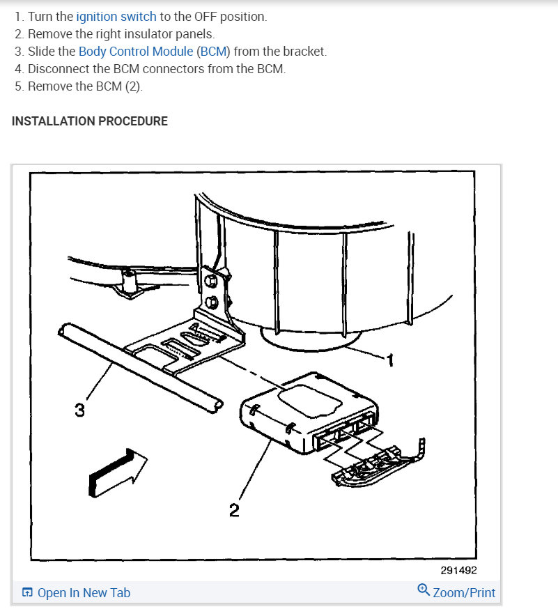

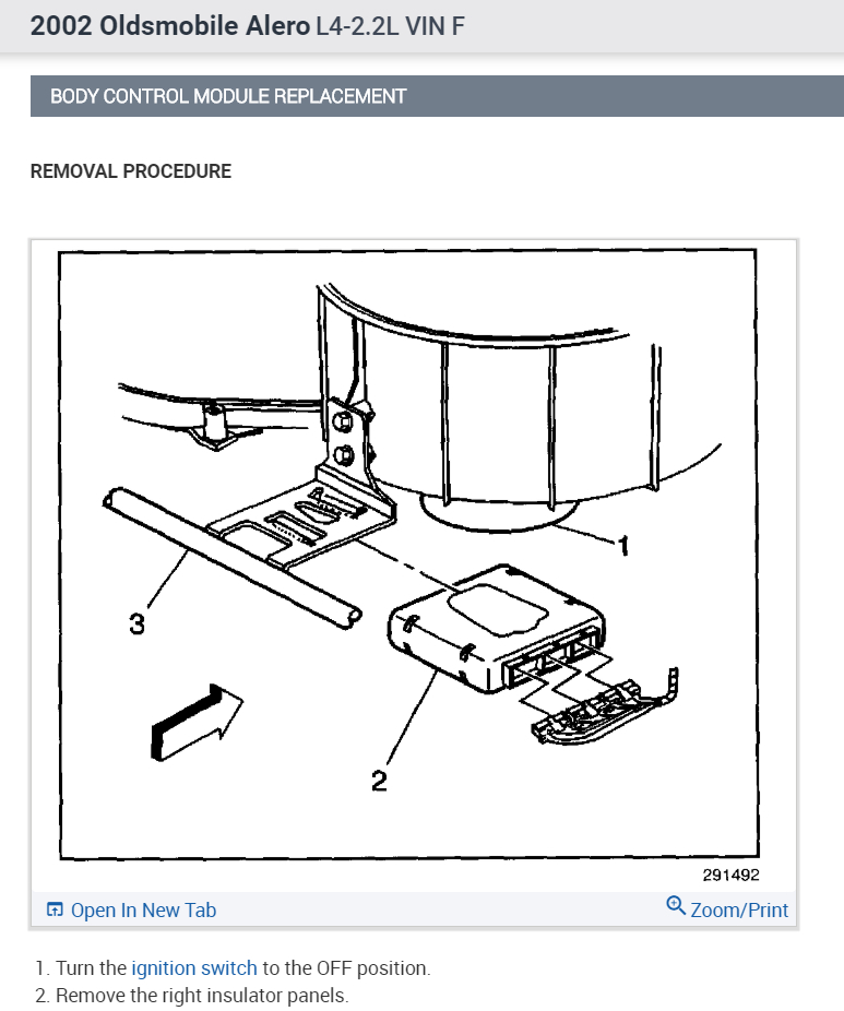

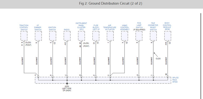

If I could jump in here, the BFC fuse runs the BCM which could have an issue causing the battery draw. Here is the wiring diagrams for the BCM and ground wires. If it checks out I have included the BCM replacement instructions as well. The ground wire is under the dash on the left side. (check the diagrams below)
1. The body control module BCM must be programmed with the proper RPO configurations. The BCM stores the information regarding the vehicle options and if the BCM is not properly configured with the correct RPO codes, the BCM will not control all of the features properly. Ensure that the following conditions exist in order to prepare for BCM programming:
