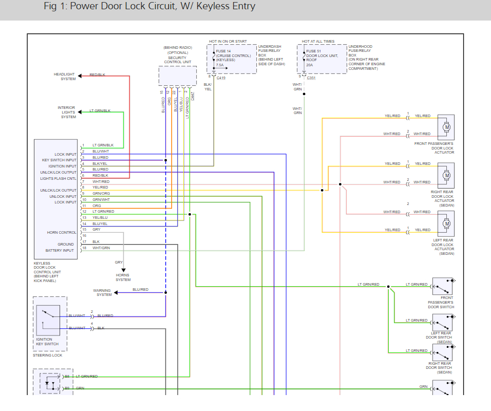

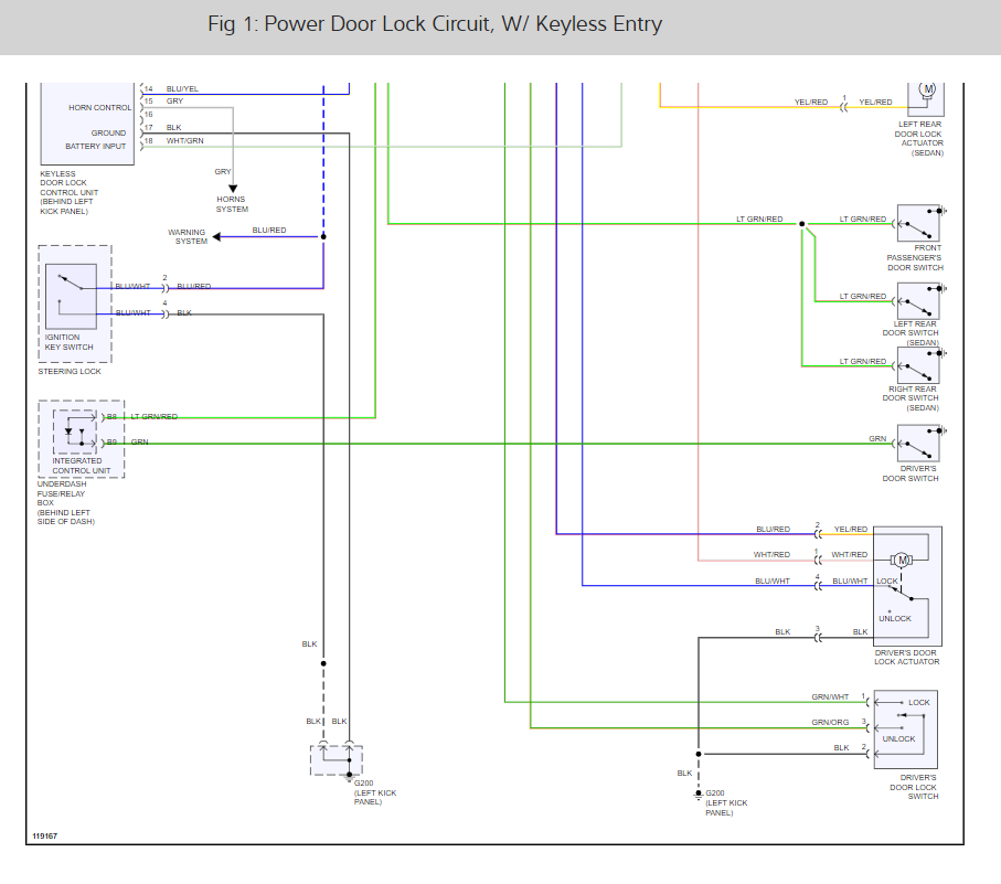

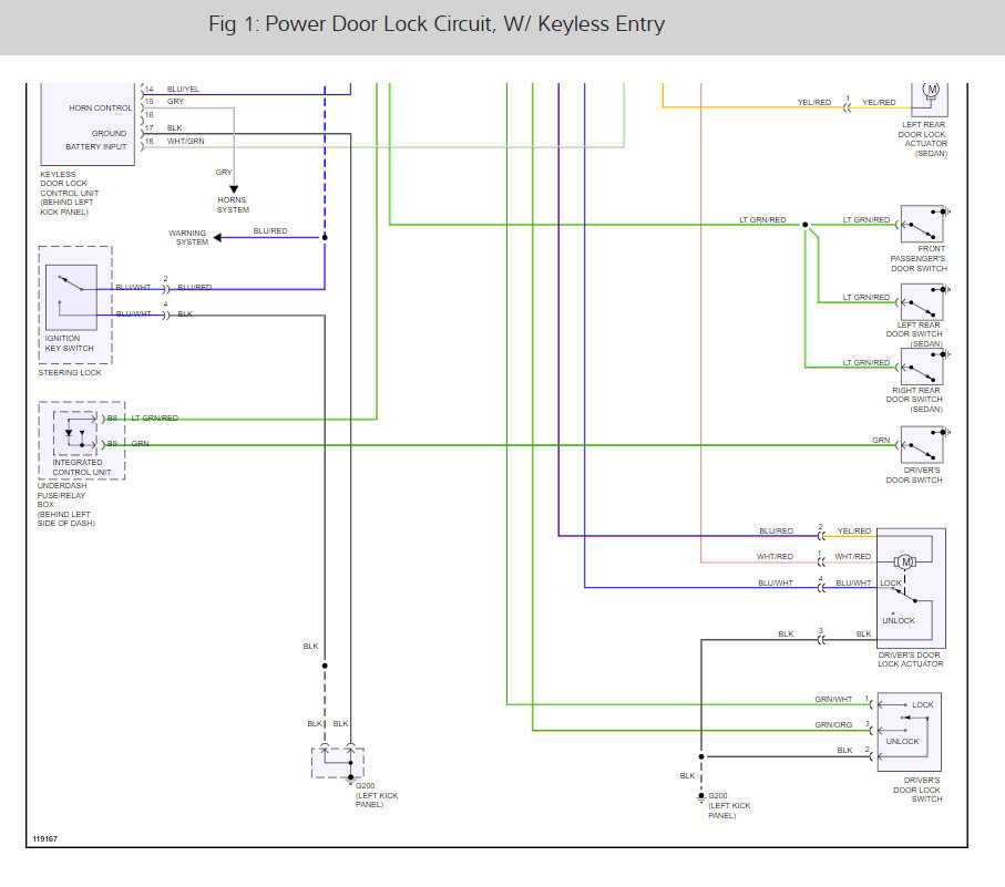

Hi mferna14, Here you are.
https://www.2carpros.com/forum/automotive_pictures/192750_PowerLock99Civic01a_1.jpg
https://www.2carpros.com/forum/automotive_pictures/192750_PowerLock99Civic01b_1.jpg

The driver's door lock actuator can be used for locking but not unlocking the other doors.
From the diagram you can see that if the lock is faulty, it would not provide power supply to the driver's door lock switch so it can cause the other 3 doors not top lock or unlock.

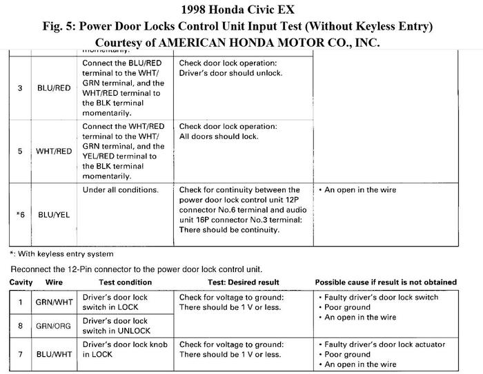

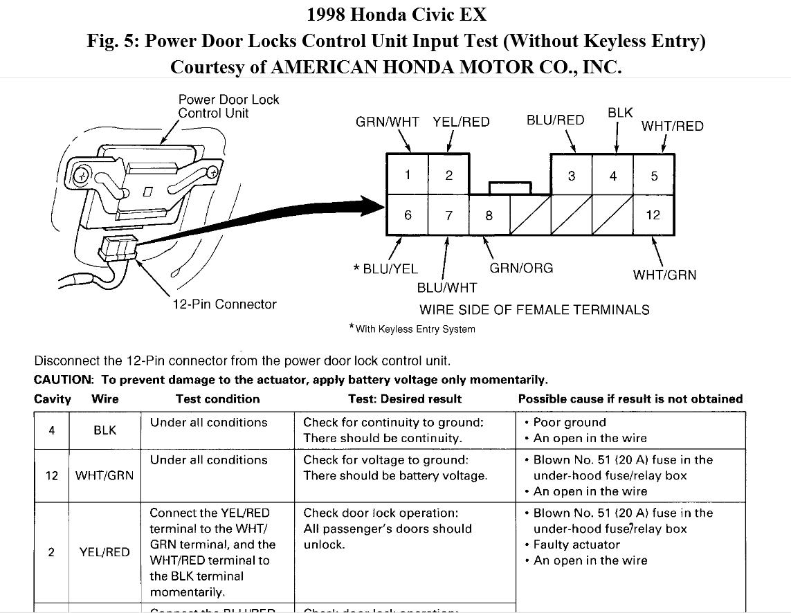

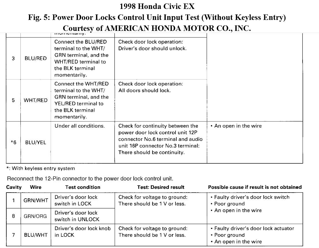

KHLOW2008
  • 41,814 POSTS
Remove left door panel. Using a DVOM, perform power door lock unit input tests. See Fig. 5 . If all input test results are okay, inspect connector and terminals for damage and proper fit. If connector is okay and power door lock still malfunctions, replace power door lock control unit.
