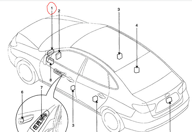

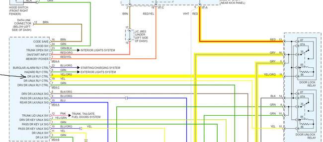

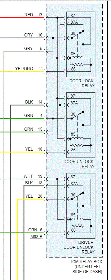

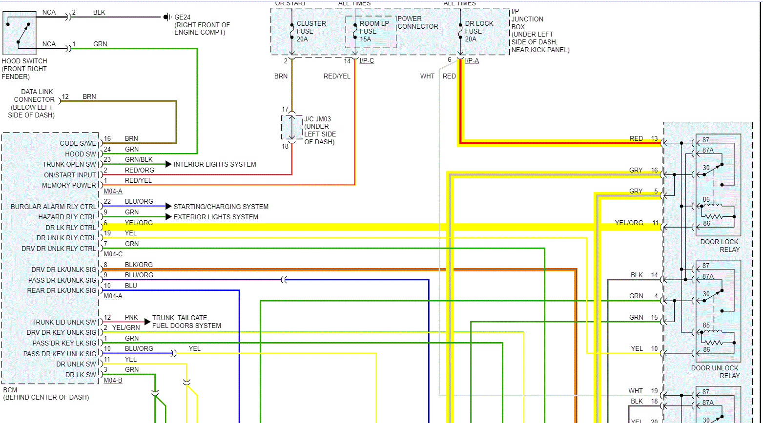

This here is interesting and not sure what it could be. Had a shop look at it and they said "bad master switch." Well, I bought a new master switch and it did exactly the same thing.
Here goes with the issue...on the driver side front door you have the obvious buttons for putting the front and back windows up and down, maneuvering the door mirrors, etc. Then you have the lock portion...again, like any normal power everything vehicle. You have the button...one end locks, the other unlocks...again, sounds very moot. The issue is that when you hit the unlock button everything works perfectly, unlocks all doors...all good. But when you hit the lock portion...nothing. It's like it is turned off. While I was doing my draw testing I decided to test that as well. Any time you hit anything or turn anything on the amps go up...naturally. However, when I hit the lock portion...nothing...stays 0.00. So there is absolutely no power going to that lock portion at all. Again, seems like it's "turned off."
Wondering if there are any suggestions. I tried getting a new master switch, still got the same result. Also got a new solenoid/actuator...again, same thing. However, that doesn't mean I didn't do something incorrectly.
Let me hear it!
Not a huge deal right now since I can just reach over to the passenger door and lock the doors using that.
Oooo, before I forget, I actually CAN get it to work with some manipulation. When the car is OFF and I manually lock the drivers front door and THEN hit the lock portion...bam, it locks all the other doors!
Can't wait to hear what people think on this :)
