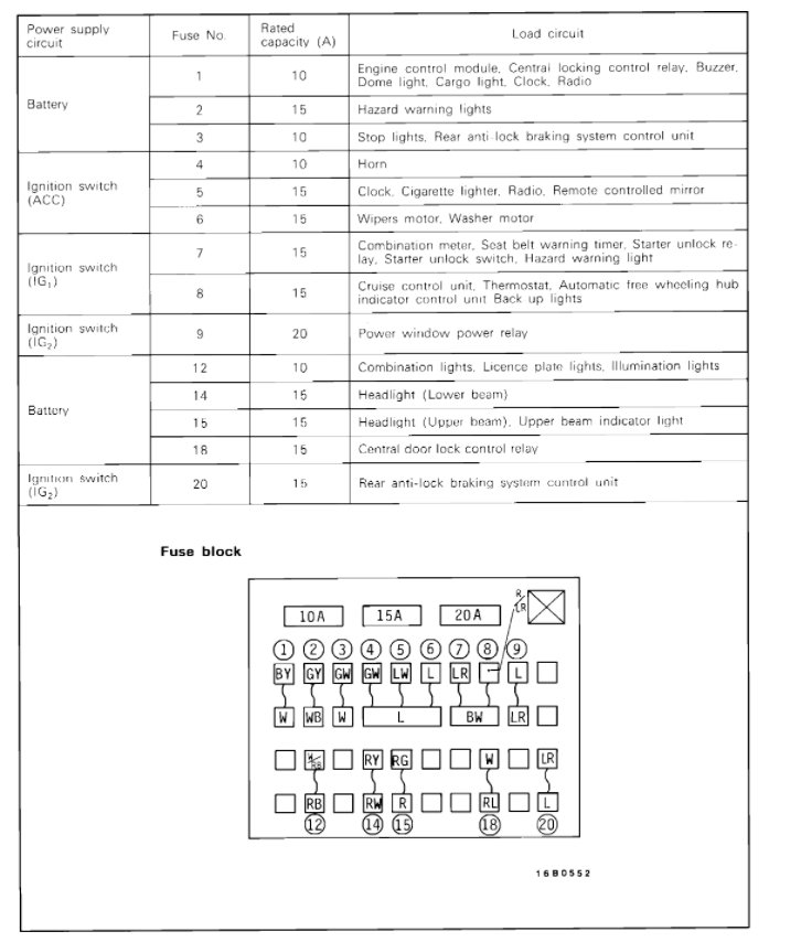

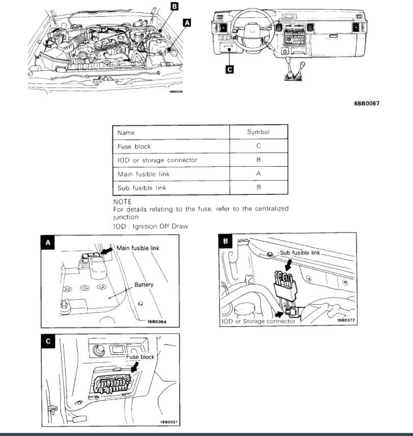

Need to locate the power boxes and what the name of the circuit it powers. Thank you
May 9, 2021 at 10:17 PM
There is a guide to help you find the fuse panel and the fuse identifications as well in the diagrams below.
Check out the diagrams (below). Please let us know if you need anything else to get the problem fixed.
