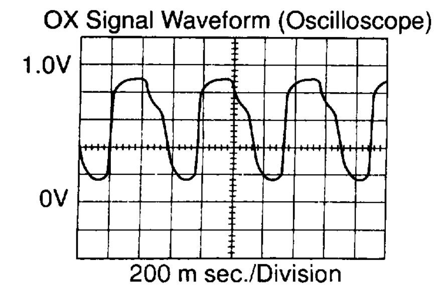

I'm trying to figure out if it's caused by a bad catalytic converter or a bad sensor. The 2 upstream sensors (bank1+bank2) follow each other almost identically, varying ~.6-.7V at idle and with some gentle punches on the accelerator pedal. The post catalytic converter O2 voltage swings wildly. After the engine is warm (driven 30 minutes), the B1S2 will hover ~.7V at idle, but drop to ~-0v when the accelerator is gently punched. Does this sound normal ? The P0420 takes about a week to re-surface after a clear.

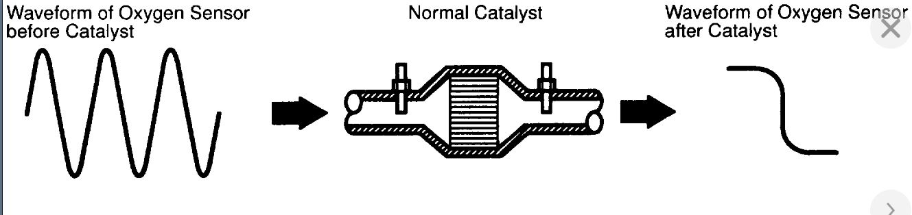

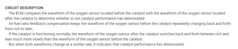

The code is for a failed catalytic converter. The precious metals are worn out.
The rear O2 voltage should be steady. If it is varying, then the catalytic converter is bad.
420 is never a sensor issue. It is always the catalytic converter that is the failure.
