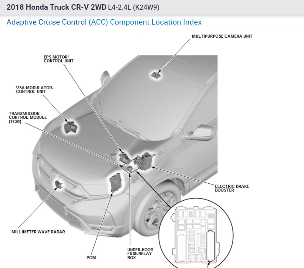

This is because the sensor on the front of the car is not working and has probably not been plugged back in when the car was at the body shop. Yes, this problem was a direct result of the accident. Here is the location of the sensors in the images below so you know where they are. It is called a Millimeter Wave Radar sensor. Check out the images (below). Let us know what happens and please upload pictures or videos of the problem.
