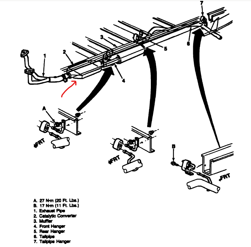

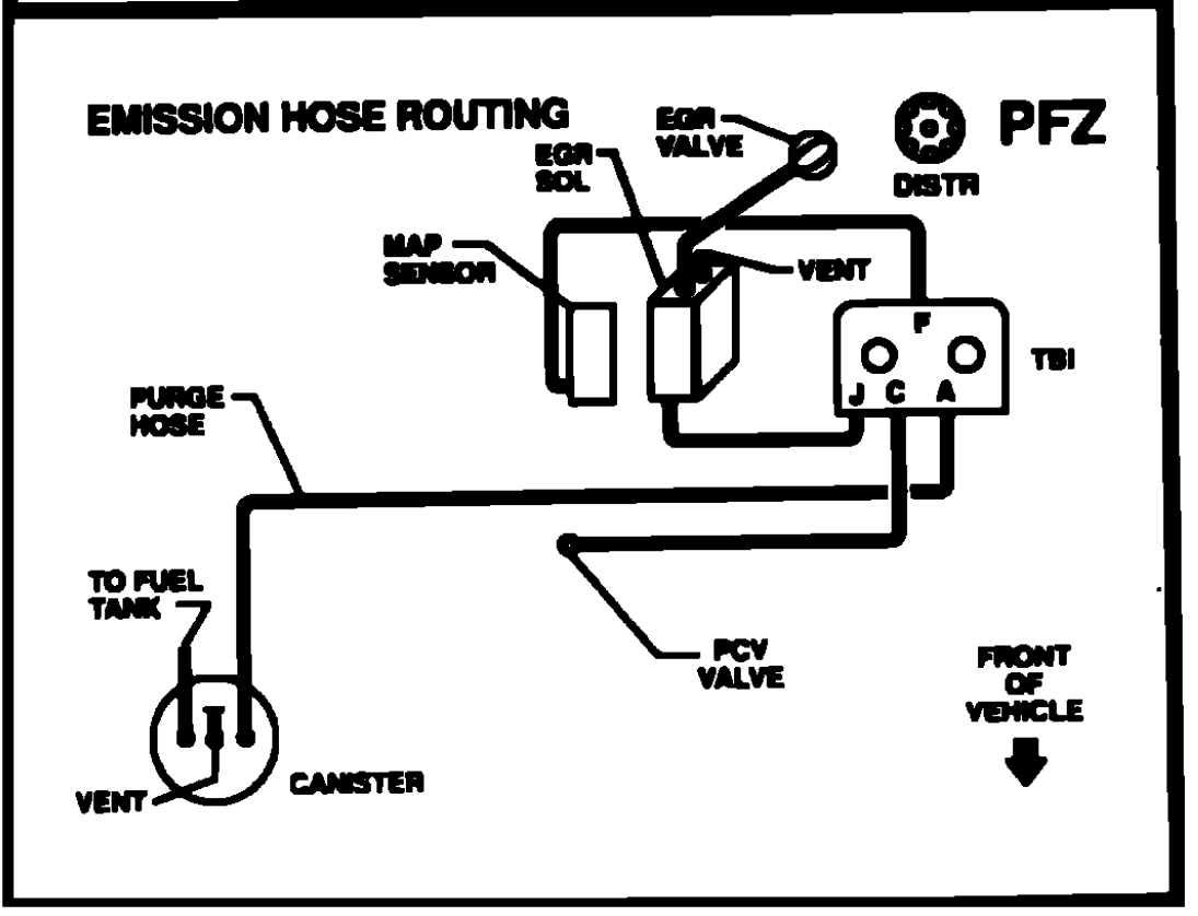

Van is a G20. I have an issue where I struggle to accelerate past 65 mph while going uphill. I can shift it out of overdrive into drive and then I'm able to accelerate up the hill. I also had a weird moment driving where I went from 70 mph to stopped traffic and the van jerked a little when shifting down. I also have another issue that may be related, air only comes out of the defrost + bottom vents and not the dash. I suspect a vacuum leak although I have replaced the hoses and am not sure how to test that or what to look for at this point.
