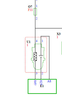

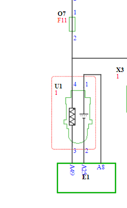

P1135, heater circuit can be caused by a bad connection at the O2 sensor, no 12V supply to heater circuit, faulty heater or faulty heater control/ground from the ECM.
Pin out at upstream O2 sensor
Pin 1, yellow/white wire signal to ECM
Pin 2, green/yellow wire signal to ECM
Pin 3, pink/white wire heater circuit control to ECM
Pin 4, brown/white wire 12V supply from fuse F11 in engine fuse block
