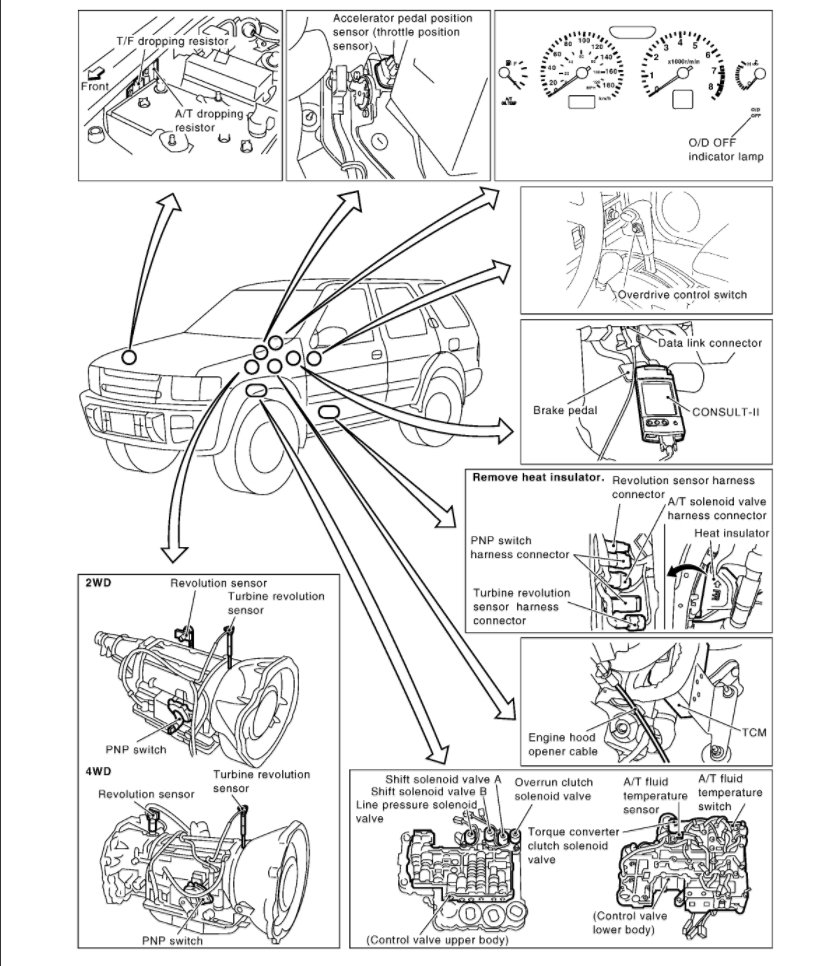

When driving at highway speed I can hit a bump in the road the speedometer dips to zero then returns to normal and the ABS light on the dash flickers on and back off. where is this sensor located and approximately what is the cost? please.
Mar 28, 2018 at 5:26 PM

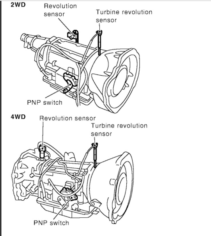

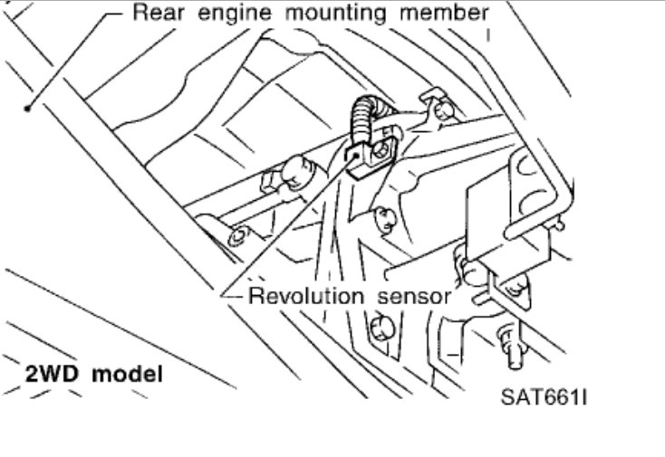

It sounds like your speed sensor for the transmission output shaft is not working right.
Once you have the sensor replaced you should run the codes to see if any are pending.
and
https://youtu.be/rTtAnsOlZU4
Check out the diagrams (below).
