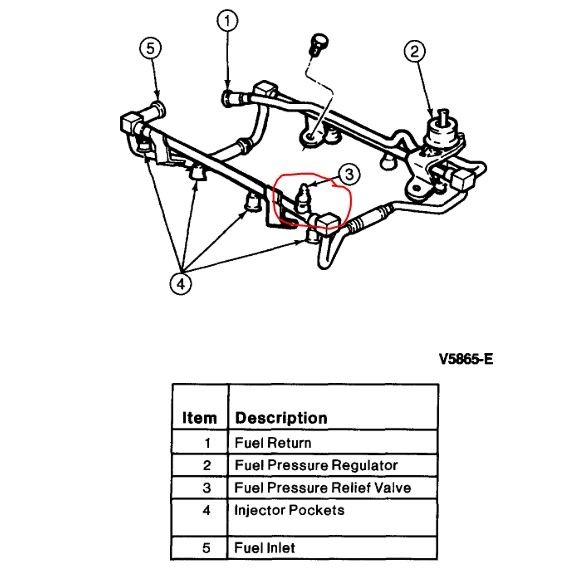

Just checked fuel pressure on fuel rail. I think it's low as you suspected, does not spray fuel it just kinda runs out.
Mar 7, 2020 at 2:39 PM
There you go. Good find.

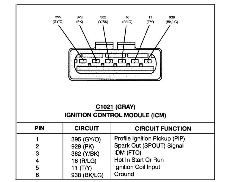

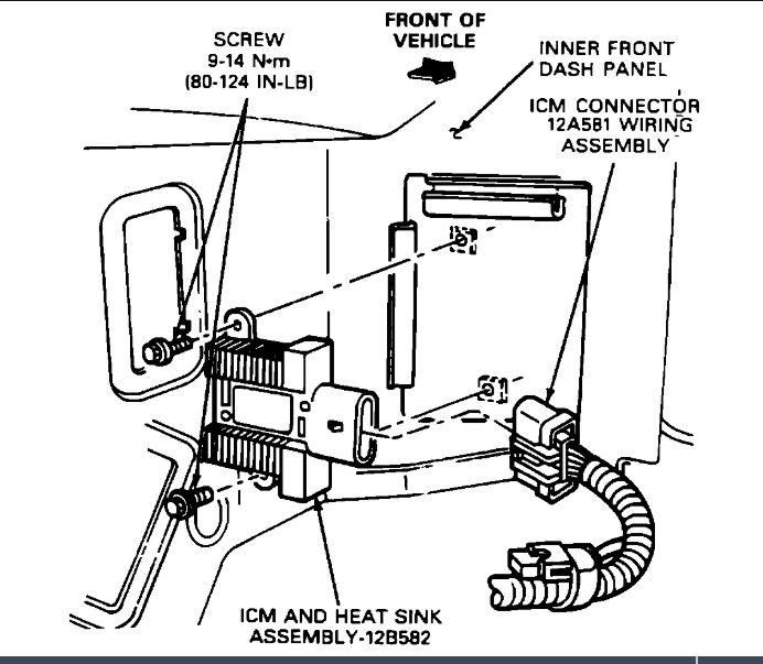

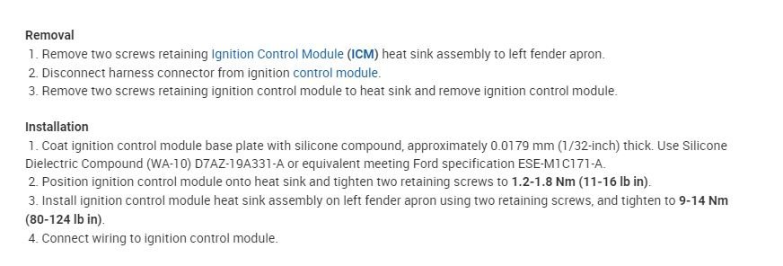

I think the problem is electrical. I originally thought it was the ICM, but when it died i put on my spare ICM ,didn't make a difference,still didn't start.when it did start i tried the other ICM and it started also.like there was no power getting to the ICM.

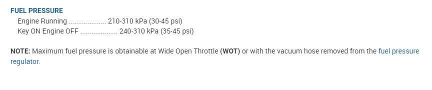

Me again.I did a pressure test,fuel pressure is around book spec's. I took it for a short drive last night,it shut off but started right back up.it was fine the rest of the way home. Any other ideas?
Mar 9, 2020 at 7:32 PM
Okay. what was the exact pressure?
Mar 10, 2020 at 2:54 AM
MORE FOR LES
  • 11 POSTS
32 psi ,when truck is running.
Mar 10, 2020 at 3:06 AM
35-40 pounds is the spec for the pressure.
I think you need a fuel pump.

Both tank's have a fuel pump. same pressure reading in both tank's. seem's to be more of a ignition problem.Truck does not sputter or starve for fuel,it's more like i'm turning the key off.wondering what would cause the ICM to not have power to it?
Mar 10, 2020 at 11:40 AM
It could be the module or the distributor pick up if it is ignition related.

to reword things; it'snot the ICM, one time when it shut off i changed the ICM with a good working ICM, still didn't start. this problem has been doing this intermittently for 4 years. I'm not sure if it's possibly the hall effect or maybe a short in the coil or maybe the power-train control module. sometimes it will go for hundred's of kilometer's without any problem's.

You will need a test light and test for power on the negative side of the coil. There should be power. Then crank the engine. The test light should flash while cranking.
If it is flashing and you have no spark, you need a coil. If it does not flash, you need an ignition module.
