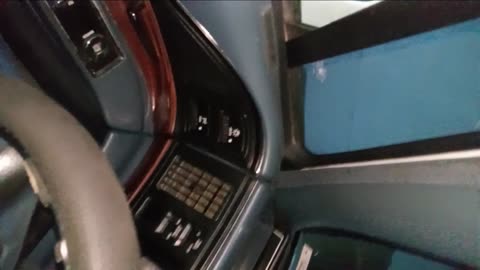

Between the door locks and the gear shifting I do not know if you can hear. I'll send it anyway.
Feb 1, 2024 at 6:33 PM
I listened to the video. I hear a loud sound which I believe is you shifting it into gear. Other than that, no luck.
Try this. On a flat surface, open the hood, engage the parking brake, and have a helper start the engine. Have the helper first place it in reverse while you watch the engine itself for movement. A small amount of movement is normal, but if it is moving more than an inch, chances are there is a bad mount. You can have the helper (while holding his foot on the brake) gently press the throttle while it is in gear to see if that causes it to move.
Try this in both reverse and drive and let me know if you see anything that seems out of the ordinary.
