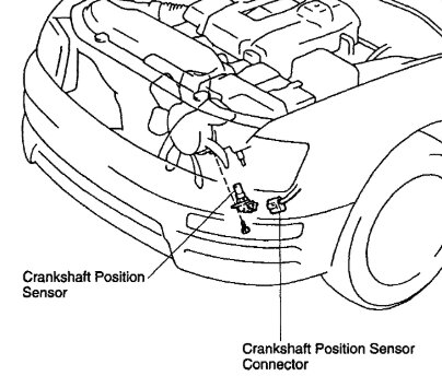

Yep, this codes comes up when the crankshaft position sensor need to be replaced. Here is the locations of the sensor, be sure to disconnect the battery for about 5 minuets to clear the codes after the repair is completed. Check out the images (below). Let us know if you need anything else.

Is the crank sensor just below the headlight? Does it plug into something? Can I access it myself if I can remove the top cover and headlights? Can it be the reason why my car under full throttle bogs down or shudders at 5500 rpm as if struggling to change gears?

Yes, the crankshaft sensor can cause this problem. The sensor is at the bottom of the engine on the left side near the front pulley.
