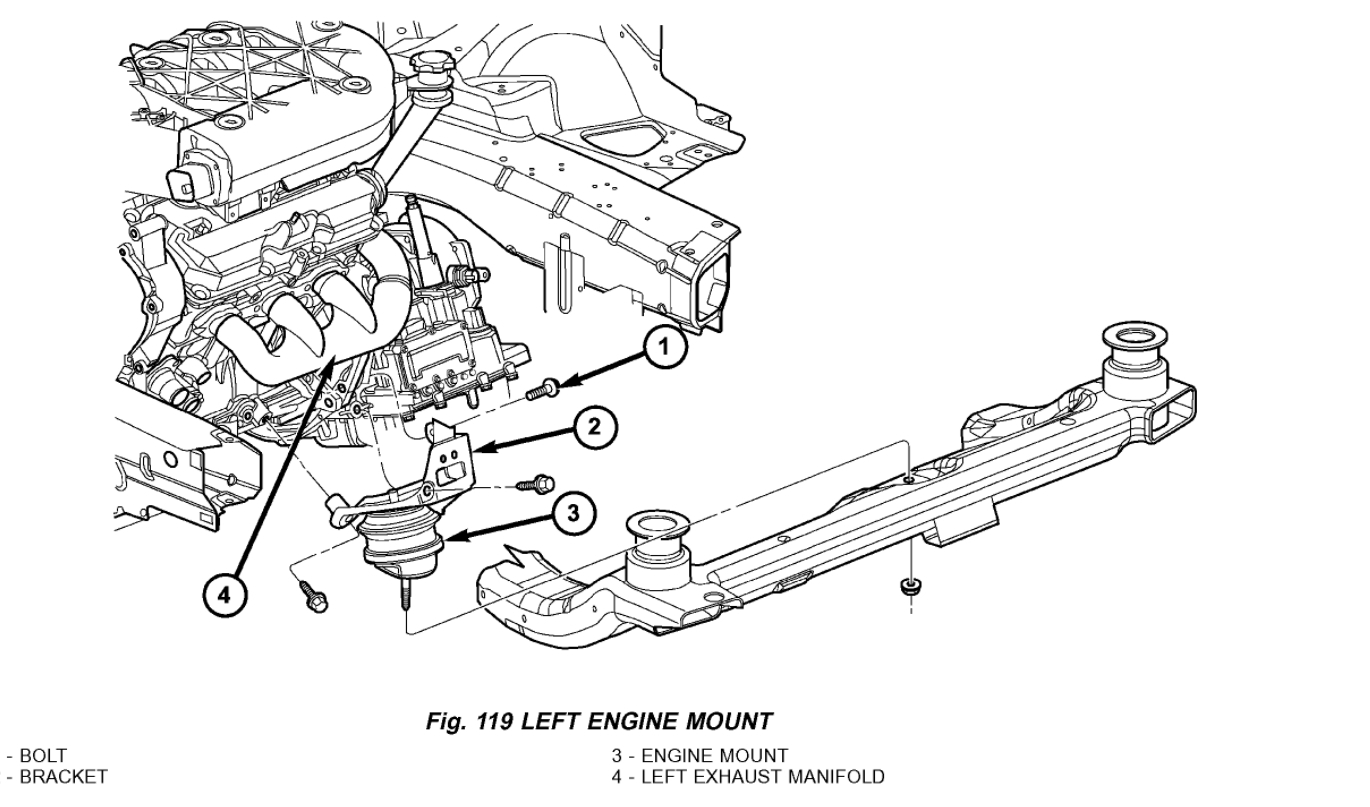

I attached the most common mount that causes this failure and allows the motor to move too much.
LEFT MOUNT
REMOVAL
1) Disconnect the negative battery cable.
2) Remove engine cover.
3) Remove radiator cooling fan assembly.
4) Raise and support the vehicle.
5) Remove both of the engine mount to cradle nuts (Fig. 119).
6) Lower the vehicle.
7) Connect the engine support fixture and support engine weight.
8) Remove the engine mount bolts and remove mount (Fig. 119).
