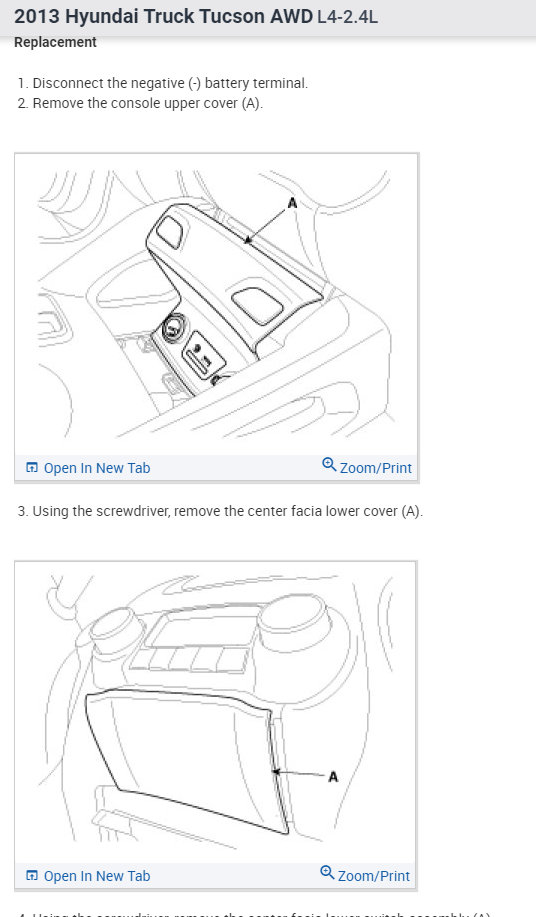

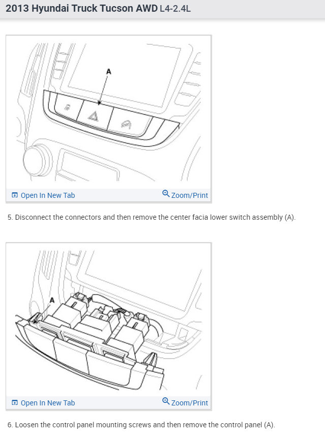

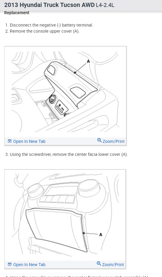

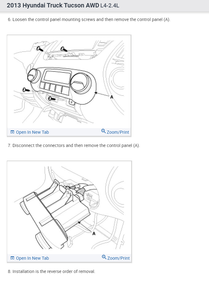

It is possible that something just got simply unplugged.
The best option would be to remove those panels and switches and take a look inside.
Look for any loose harness or broken pieces.
Keep in mind that depending on the impact it can have internal damage to the control switches.
I have attached diagrams of how to remove the HVAC control panel below.
