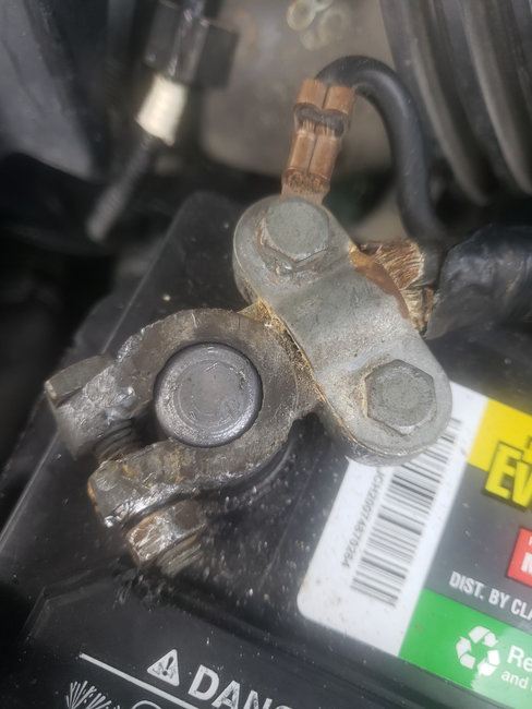

We have owned our van for 2 months with no problems. Two weeks ago, it wouldn't start, just clicked. I tried to jump it with cables and then a jump pack. Figured the battery was dead (it was from 2017) so I bought a new one. Van started right up and ran fine the rest of the day, with multiple times starting it.
The next morning it just clicked again. Tried jumping it and wouldn't start. Took the cables off, took the battery back to Walmart and they said it was fully charged and had no problems. Put the battery back in and it started. Turned it off and it wouldn't restart. Took only the positive cable off and put it back on. Started. Ran great for a week, then just clicked again.
Took the positive cable off and put it back on. Didn't start. Loosened the positive cable's bolt 1 1/2 turns (didn't move the cable at all) and it started right up. I haven't messed with it for 3 days and it's been fine.

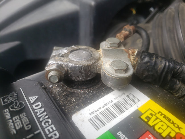

I also wanted to note that twice I noticed a pop and a spark with some smoke from the positive battery cable when it would just click. Once from the little bit of bare cable right in front of the cable clamp and once from in the crack where the post and cable connect.
I think that's all, thanks for your help!

You've already diagnosed the cause. You just don't know it yet. Thank you for posting the dandy photos. There's where I see the first problem. The cable clamps are universal replacements, but they were never intended to make permanent repairs. Those are only meant as a temporary fix to get you back on the road for now. The proper repair is to replace the cables. When it became necessary to cut the original clamps off to replace them, it was because the copper wire strands had corroded off. That corrosion extends well down the cable under the insulation where you can't see it.

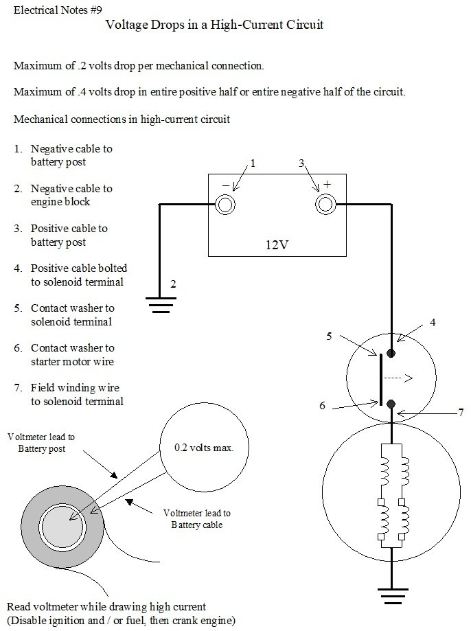

The next concern has to do with the sparking and smoking. We don't always get such helpful clues. The story here refers to "voltage drops". Basically, you start with 12 volts from the battery, and when a circuit is turned on, all of that 12 volts gets used up at various places.
I should make a side note and explain the battery's voltage gets drawn down when it delivers a very high current such as in a starter circuit. Under normal conditions it will get drawn down to as low as 10 volts, but we're not dealing with normal conditions here. For this story, 12 volts is normal and what we expect to start with. Under ideal conditions, all of that 12 volts will be "dropped" or used up, across the starter motor. In reality, there is resistance to the flow of electrical current, and that causes a small amount of voltage to be dropped across it when current is trying to flow. This is exactly the same as water flowing through a garden hose. If you start with 50 psi at the faucet, all of that gets used up by the time the water leaves the nozzle, but only when that nozzle is open and water is flowing. That's the normal condition. An abnormal condition would be when you place your foot on the hose. That adds undesirable resistance, and the flow of water slows down. We still use up all of the 50 psi, but now some of that pressure is dropped across your foot, so there's less left to shoot the water out of the nozzle. If you want more water to flow, you must remove your foot. If you want still more water to flow, you need a larger-diameter hose.
This is why in an electrical circuit, if we want to be able to get more current to flow, we need bigger diameter cables. Starter circuits use the biggest cables on the vehicle. That's to lower their resistance. What you have now is so much resistance in the entire circuit that enough current to run the starter motor can't flow. There's too much resistance, and we have to figure out where that is and remove it. This "Notes Page" is a copy of what I handed out in the classroom. It shows all the common places we're going to find excessive voltage drops. I'm going to skip over adding confusion with the starter motor itself because we already know it is okay. By far the most common cause of undesirable resistance is the mechanical connection where a cable clamp is attached to the battery's post. That's points 1 and 3 in my sad drawing. We have to add two more points not shown. Those are where the cables are clamped to the aftermarket clamps.
It sounds like you've seen the sparks on the positive cable clamp, so I'll limit this discussion to that point. With your garden hose, its small diameter is what limits how much water will flow through it. That means the hose has resistance to the flow of water, but that resistance is small enough to have little effect on its operation. Now imagine if you could place two water pressure gauges on the hose, about six inches apart. We know the further along the hose you go, the lower the pressure becomes, but it's going to be a very gradual decrease. Lets say in the middle of the hose you find 25.0 psi on the first gauge, and 24.9 psi on the second gauge. That's normal and acceptable. But, now if you place your foot on the hose between the two gauges and measure again, you might find 35 psi on the first gauge, and 15 psi on the second one. That's a pressure drop of 20 psi. That is unacceptable and will prevent the system from operating properly.
Those two gauges were almost in the same place along the hose, so normal would be to see the same pressure at each one. To say that a different way, the pressure difference should be nearly 0 psi. That brings us to your starter circuit. If you look at the lower left of my drawing, it shows the two leads of the voltmeter on the battery post and the cable clamp bolted to it. Those are also the same point in the circuit. The voltage should be the same at both places. With the garden hose we took two pressure readings, then calculated the difference. We could do that in the starter circuit too, but it's way easier to take just one reading of that voltage drop as it occurs. Also, as water needs to be flowing in the hose, current needs to be flowing in the starter circuit. That means you'll need a helper to run the ignition switch while you run the voltmeter.
If you've never used a voltmeter before, look at this article first:
They're using an "auto-ranging" meter in this article. That's an expensive feature you don't need. Harbor Freight Tools has a perfectly fine digital voltmeter for around $7.00. You can find them at Walmart and any hardware store too. If you need help setting it up, I can help with that too.
Place one probe on the battery post. Place the other probe on the clamp attached to that post. The meter will show 0.00 volts. Now have your helper turn the ignition switch to "crank". In a properly working circuit, you're going to find a reading of less than 0.2 volts while the starter is cranking the engine. That's due to current flowing through the tiny amount of resistance that can't be avoided between the post and clamp.
The goal now is to catch it while the problem is occurring. Do the same test and see what the voltage is when you get the failure to crank. If it's 0.00 volts or real low, move on to the next mechanical connection. On your vehicle, leave the probe on the clamp, and move the other one from the post to the copper wire strands next to the strap on the clamp. Here again, these are the same points in the circuit, so you should find 0.00 volts. If the actual voltage is high when your helper tries to crank the engine, that is the connection that has the excessive resistance.
At a minimum, where you find the high voltage, that mechanical connection must be taken apart and each part cleaned and shined up, then reassembled. It sounds like you may have more than one intermittent connection, so don't be surprised if the problem occurs again after the first repair. Simply repeat the test procedure on all the other connections until you find the next one with high resistance.
Also be aware digital voltmeters don't care about polarity, meaning which probe goes where. As I had you move the one probe, one of your readings would likely come up with a minus sign for the voltage. You can ignore that and just look at the value. If the negative reading bothers you, just switch the positions of the two probes. You'll get the same voltage reading but without the minus sign.
