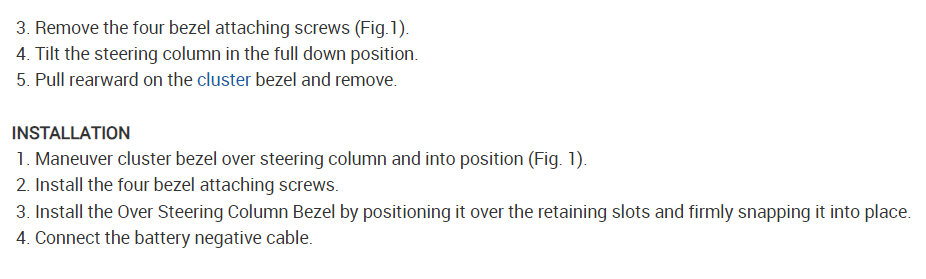

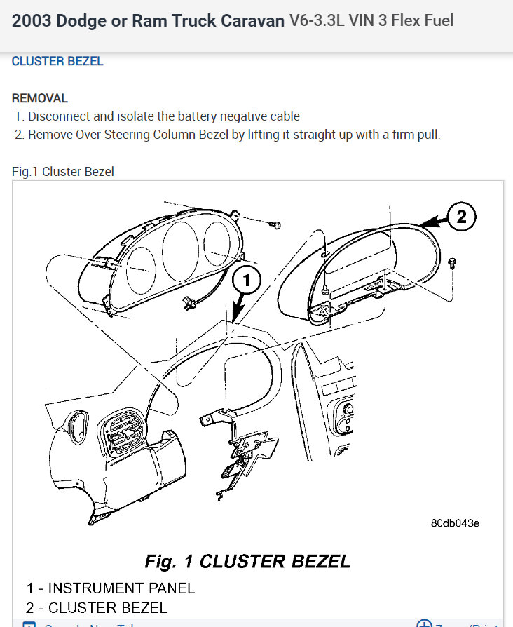

So, the odometer adds mileage when the van is sitting still, correct? The only thing it can be is the cluster, this is where the mileage data is stored. Here is a how to remove the cluster so you can send it in for repair, just search google or eBay for a service close to you. Check out the images (below). Let us know if you need anything else.

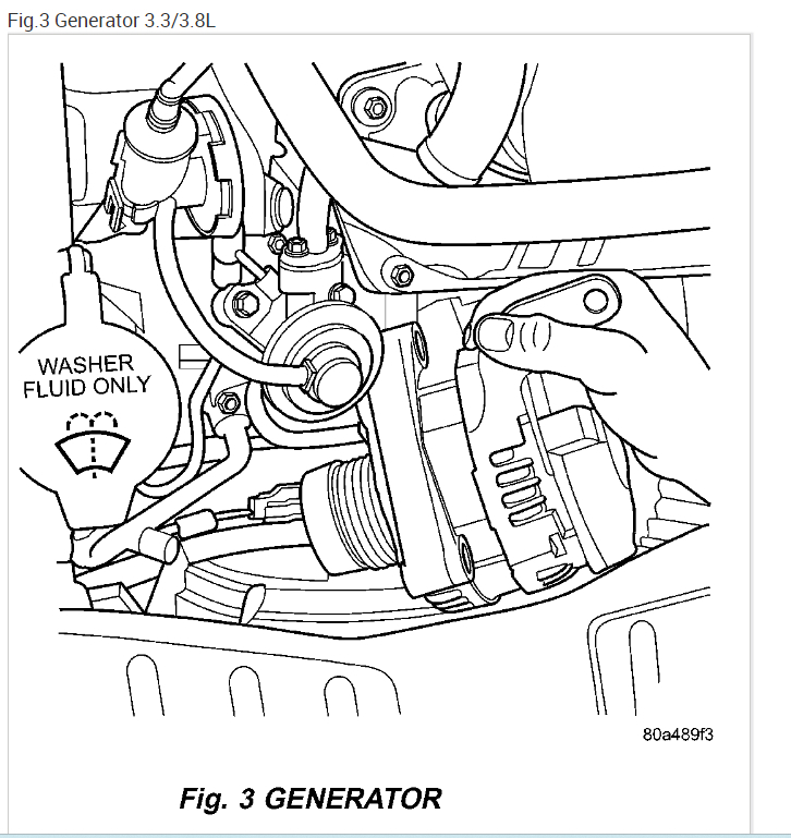

(Oddity) I noticed that every time the driver's door opens the odometer lights up on the dash (dash lights turned off) The alt. shows bad Diode(s)and a lot of A/C Voltage into the system as well. I wasn't questioning the suspect cluster failure but more to the overall cause and effect of the other known electronics to be sure the odometer is an isolated problem and not an inclusion of this other problem at hand.
Mar 27, 2024 at 8:49 PM

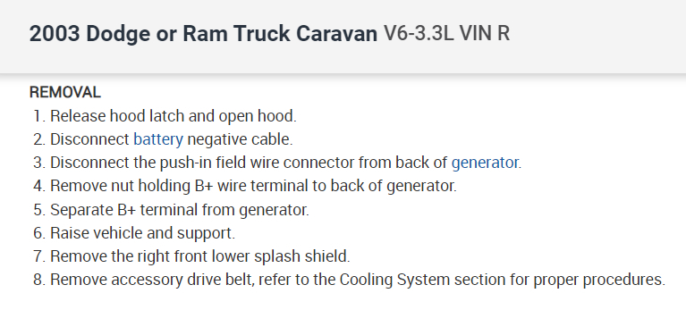

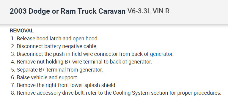

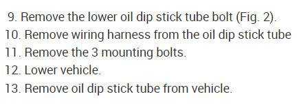

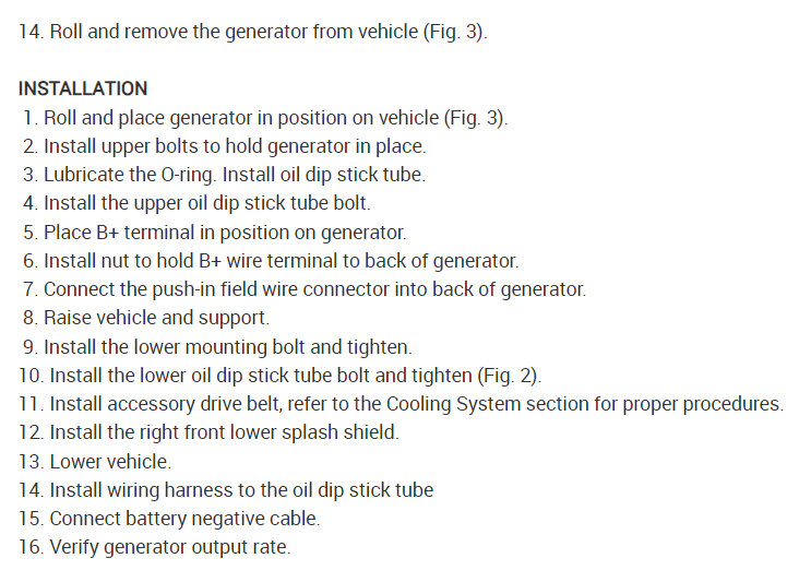

Yep, the alternator throwing AC voltage can be the problem. I would change it out, here are the instructions on how to do so. Check out the images (below). Let us know if you need anything else.
Mar 28, 2024 at 8:54 AM
