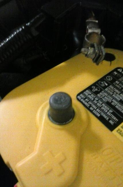

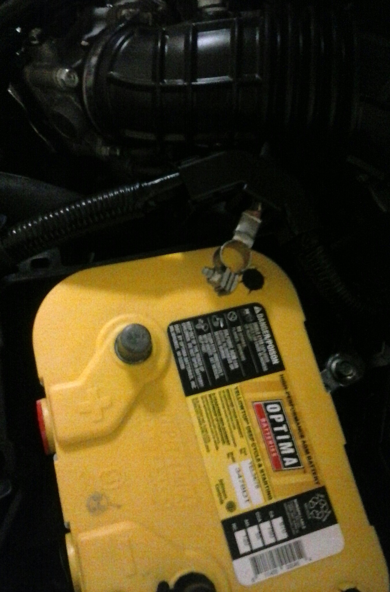

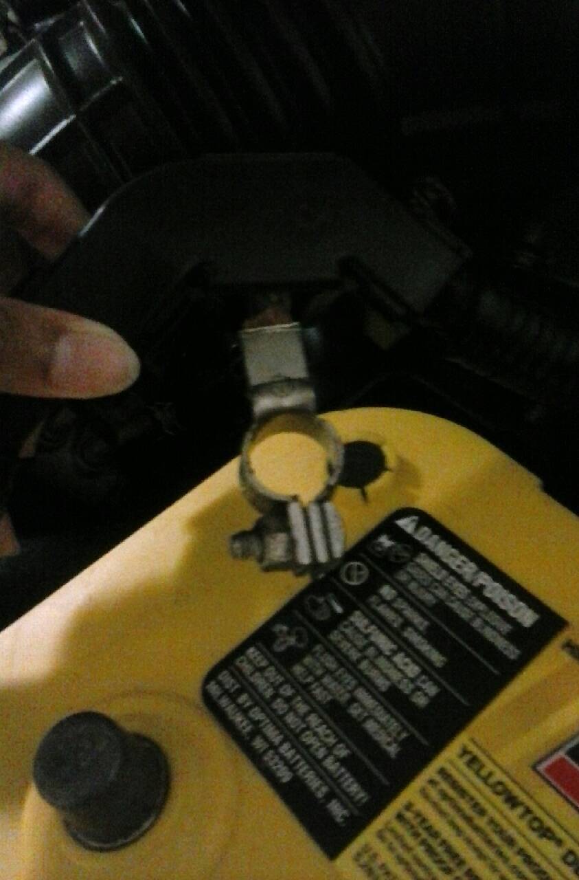

You're better off returning this battery and getting the right one. You still have to worry about the battery's posts hitting the bottom of the hood when they're in the wrong place too.
